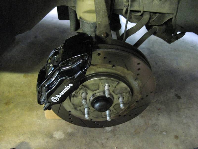

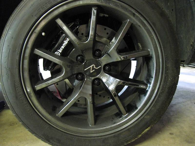

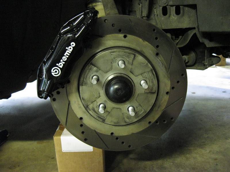

So, I've had these 2000 Cobra R Brembo calipers for my 98 LSC for a few months now, but have had so much crap going on lately that I haven't even been able drive the 98, let alone work on it.
I had a little bit of time today, so I took the chance to fit them up on the car, just to make sure they'll work with my wheels.

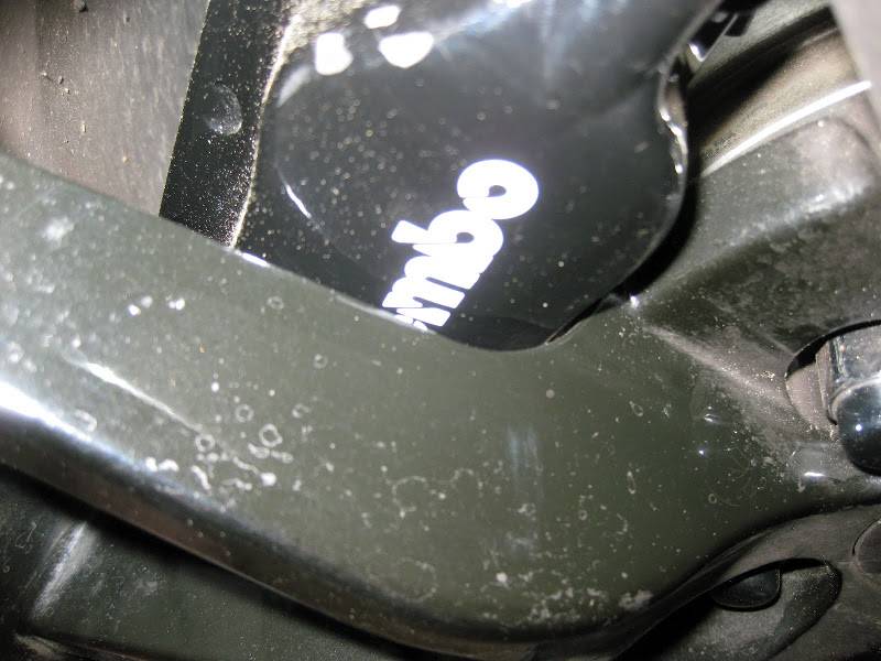

They JUST barely fit. There's about a 1/16th of an inch of space at the spot closest to the center, and gradually gets a little bigger the farther out you go.
Here's some pics...I know this caliper is on the wrong side (the bleeders should be pointing upward), but it doesn't matter for fitment purposes. Both sides are identical...
Oh man, that's CLOSE! It almost looks like if you rotate that wheel a little counter-clockwise, the spoke will rub the bump under the piston. But those brakes look fantastic! And I love the FR500 wheels. They look like the old "styled steel wheels" from the early 60's Mustangs.
Yeah, I spun it very slowly and watched the spoke the whole time, and it doesn't get any closer.
I had to be very careful when I was putting the wheel on too. Before I put the lug nuts on, the wheel could be wobbled enough to hit the caliper, so it needs to go STRAIGHT on.

Once you get it out on the road I would flatten out a piece of putty on the calipers and take it for a easy drive to see how much flex you're getting in those rims, at least before you do any spirited driving.
Everything moves a little, better safe than sorry.

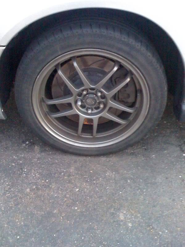

When I put my big brake setup on my WRX I actually had to grind the outside of the caliper cause it rubbed the inside of the rim. It uses the stock calipers with 14.5" rotors.
Made the biggest difference in the world as the stockers were 10.5 or something like that?
If I get a set of 17" or 18's for my Mark I'll get some big rotors and try it :cool:
