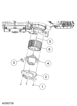

Anybody know if the HVAC blower motor can be replaced without pulling the dash? Mine is making some noise, would like to replace, but not if it requires pulling out the dash.
joegr
Dec 10, 2005
21,110
2,075
Gulfport
Yes, it can.
Removal and Installation
  1. Remove the RH floor duct.
  1. Remove the 3 blower motor screws.
  1. Remove the blower motor cover.
  1. Disconnect the blower motor electrical connector.
  1. Remove the blower motor.
  1. Remove the blower motor wheel clip.
  1. Remove the blower motor wheel.
  1. To install, reverse the removal procedure.
