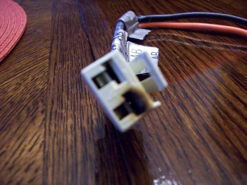

I checked them when it seemed like it wasnt blowing fast enough when I bought it. They were fine and just figured the blower was dying. After it runs for over 30 minutes it looses speed too even in manual mode.
I found that this wire was burned on one end. Would this cause the blower not to blow?
