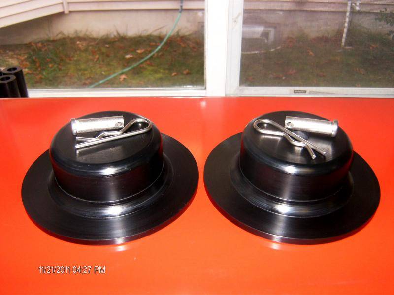

Do you make these upper spring perches/mounts pictured here? Do these work with any rear spring either lowered or standard height? Also how does it mount? Or does it just hold itself in place with spring pressure?
I do. They'll work with any springs that will fit an '89-'97 Thunderbird and fit in a Prothane 6-1709 spring isolator.

Ok, question..do you need to use rubber isolators with your upper and lower perches? As it is, these ad a little height to the rear if each is 1/4" thick, so isolators would ad to that even more right?
I chose to use the rubber isolators on the top and bottom because I didn't want my coils riding on the perches. The perches are meant to keep the spring centered not support it IMO. If you are concerned with ride height, don't put T-Bird SC springs on your car like I did. My car sits higher. No one likes it, but I haven't found a reason to give a crap yet. Then again, my intentions are different. If I run low 13s on this setup after the dyno tune, the springs are staying in and I will be sure to brag about the fact that I can do such things on coils.

The perches are designed to use the Prothane 6-1709 isolators. If you're using Thunderbird lowering springs F&R, the added thickness is needed as the pockets in the Mark VIII LCA's are deeper than the pockets in the stock Thunderbird LCA's. I originally designed the perches to use in Thunderbirds that had "upgraded" to Mark VIII LCA's, and found that the perch base and isolators were needed to maintain the same ride height in the rear.
Oh ok, that I didn't know..figured the only difference between the thunderbird and mark was the fact that the LCAs were aluminum instead of steel..thanks for the info, Ill be ordering springs and shocks soon, so do you have a supply of these made already or are they made to order?
They are made to order and shipped 5-7 days after I receive payment.
