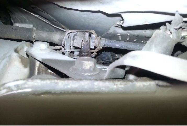

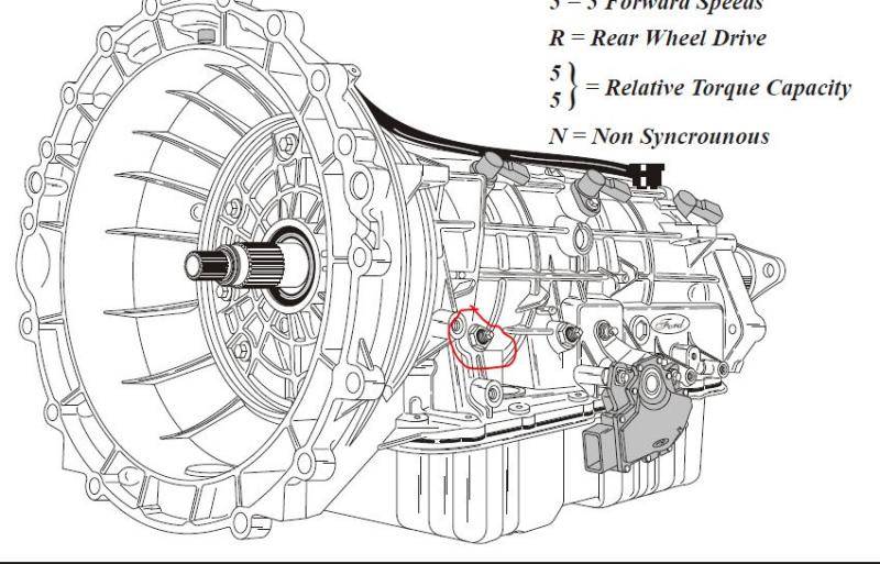

So I lift the car to try a band adjustment and check if the band was ok or at least stay there :(
I can access to one screw , when I touch it i discover that it was loose :confused: i can move the screw and nut just with hand and zero force, i was in shock ,so no doubt i have to drop the tranny.
wait ...
There Are more , another cheap fix . What part is it? e-brake retainer?
best regards!
--loose overdrive adjustment screw , both spins,nut and screw , just moving with hand.
[video=youtube;_iggGd-AStA]https://www.youtube.com/watch?v=_iggGd-AStA[/video]
damm i Dunno why it's vertical >_<
[video]https://youtu.be/OWiir4g1wlk[/video]

BTW, the lock nuts on the band adjustments are one-time use. You should get new ones, or you may have a leak or two when you are done.
Edit: Need better pictures... It looked like a toe-link at first, but I don't think so.

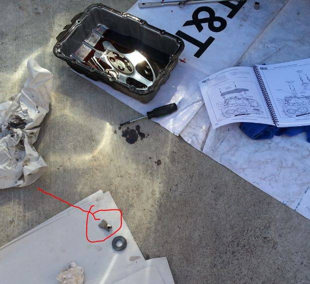

We drop the pan and found a valve body screw [emoji52] and a band adjusment strut (overdrive)
There's no chirps o metallic parts, looks good, the oil has good colour but never changed i believe.band strut.JPG
The wire tie was a kind of shift cable retainer, the plastic one was broke.
