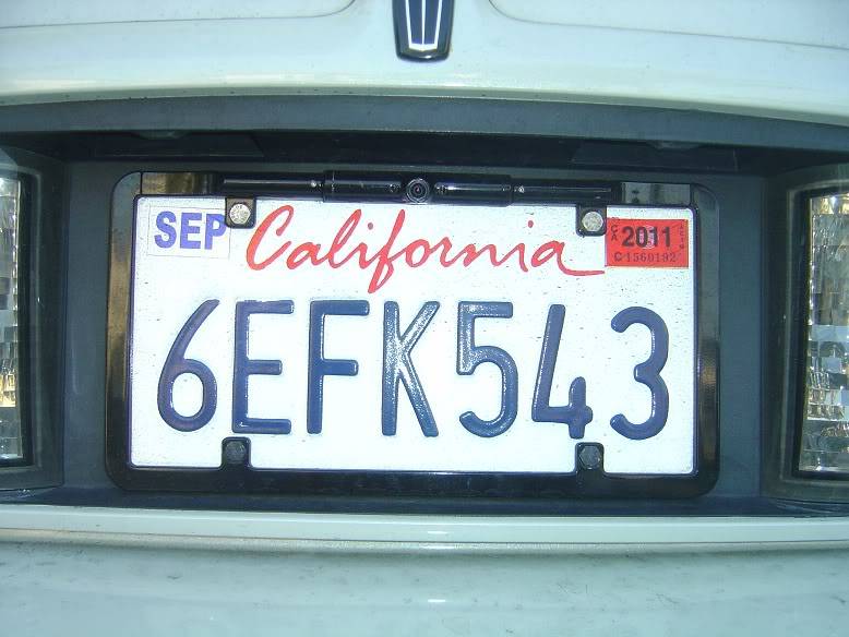

I have the license plate one. Not the one you screw on your license plate but one that is built into a license plate. The license plate is black. And the camera across the top of the plate is thin so it doesn't stand out. You can't notice it unless you're looking for it. Back up can helps a lot when backing up at night cause of my super dark tint

Yeah there are cheapers ones, I actally got it from 125 by looking around online. I went with this one because you can't see it, it's slim and hidden in the plate frame. I thought it was a great buy.I thought about going with a plain camera to save money, the ones where you drill a hole to install, but it wouldn't look good IMO.

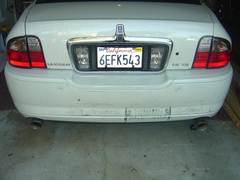

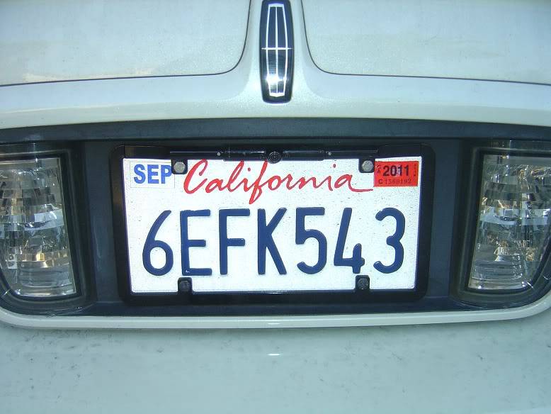

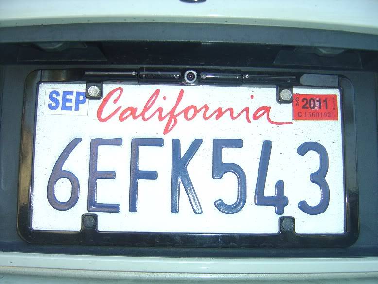

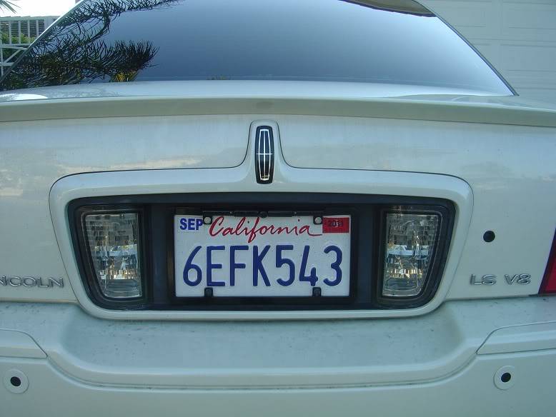

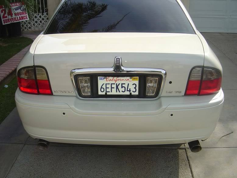

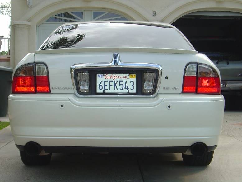

Alax I don't think I've ever seen your actual camera setup on the rear... Any photos?
not close up pics to get just the camera in view,here are some close ups of the rear. I'll get one up close tom.
Man my old were tips look tiny
Oh cool that is hardly noticeable! I am kind of wanting to do this when I get a new headunit.

OK then......How did you wire it into the stock NAV screen? That looks very nice and would compliment the factory ERPA nicely.
It's not noticeable at all to me unless you know it's their & you are trying to look for it. I like it...looks good. How does it look at night? Do you have led's in your reverse lights if so does it glare the picture?
Looks good at night too. I think they sell some with night vision, but I dont need it. I acutally dont have led's in the reverse lights, it's the last ones I have to convert.
I bought a video interface to play movies with from my ipod. It came with 2 video inputs plus one for a back up camera. The video interface switches to the camera input when you put the car in reverse and I wired in the camera to get power from the reverse lights. I had to make a small hole on the rear surround to get the cable through and also buy longer screws for the top of the camera plate because they weren't long enough.
I'll get a video of it soon to show you guys. Oh and the wide angle needs some getting use to, if you've never seen a wide angle back up cam you'll see what I mean when I put the video up, but it's very useful when backing up when cars are blocking your sight.
