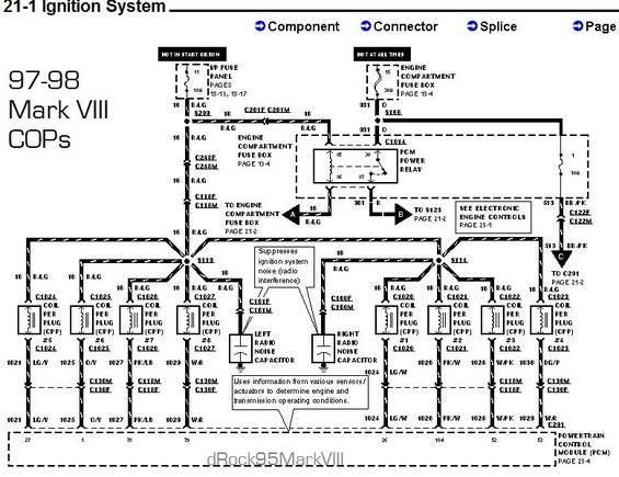

But I need to correct you on one point. All Marks use the "wasted spark" system. Even the 97/98s. The COPS are wired in series, so just like all other Marks two spark plugs are fired at once. The coil packs contain the 4 coils per pack with two "wired" as pairs. All the 97/98 COP system introduced was splitting up the coils and locating up on top the spark plugs. In the end, both systems have 4 "trigger" wires to control the system.
I agree on all you points. And to add that these are aluminum blocks so more changes means more potential wear on the threads of the heads.
The 97-98 Mark VIIIs w/ COP used individual ground triggers for each COP from the PCM for individual cylinder spark control:
(click fullsize)
(Note that they share a common, fused power source. But the ground is triggered separately by the PCM for each COP.)
This is what allowed the engine torque modulation feature to be added to the traction control, just like they did in 1998 for panther platform cars when they went to COP. With individual cylinder coils, spark output could be controlled at individual cylinders to limit power (as well as fuel injector output)
They are not in series. If they were, you would not be able to get a single cylinder misfire code from a failed COP - as if one failed the other in series would also be disabled. If the COPs were to be wired using a 4 wire trigger system (ie retrofitting COPs using a stock -96 EDIS system) you would want them in parallel that way if one fails the other cylinder using the same ground trigger would not also be disabled. :)
