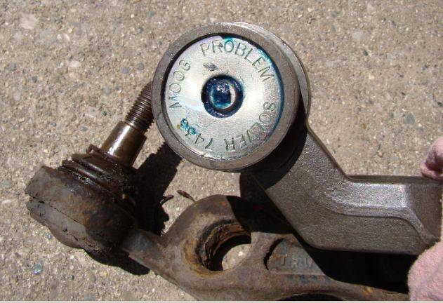

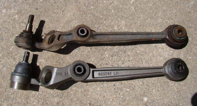

Ordered all my front suspension stuff from Rockauto. Got to checking out all the parts, and despite all being boxed as MOOG, one of each is very different. One upper, and one lower are not stamped with TRW, and have very different bushings. Obviously I don't feel comfortable running these. Seeing as suspension components, hurt when they fail.
I called Rockauto today, and the rep I spoke to was very helpful. I sent him comparison pics, and he has the warehouse checking their stock so I get the correct pieces.
He did say that MOOG has gone to greaseable bushings. I have built a few of these front ends before (big PITA with hand tools), and they have always been sealed fittings. Anyone else heard of this?
Comparison pics:
Uppers:
Lowers:
Luckily they stand behind their stuff, and seem willing to help get this corrected as soon as possible.
Moog is only a brand, not a manufacturer. They pack what they have, and don't give any guarantee, that only TRW parts are packed into Moog boxes.
And it's really a pity, if Moog stops packing TRW parts, that are the same as Ford-Genuine-Parts, but a little cheaper.
I just got the same lower control arm from Rock Auto. I don't think I'll order from them anymore.
The ball joint is made by Moog. The forging is different.
All the other ones I've used had the TRW forged arm.

Hoping their warehouse will find replacements of the other design to match. The design of the others, looks like a much better setup than the black rubber boot. I'll know Monday what happens.
I don't know, every original lower control arm I've replaced was because there was a hole in that accordian style rubber boot.
This black boot looks pretty thick. I guess I'll see how long this one lasts.
The thicker forging scares me a bit though. Just like cheap tools, they are usually thicker because of lower quality steel.

OK - Moog has switched to using their own castings.
Don't expect to find TRW parts in Moog boxes any more..

Only thing that irritates me, is the replacement lower I received is not the exact same style as the other,but close enough. Looks fine, so I am just going to use it.
