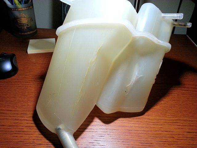

I know everyone is saying change the degas bottle, but I've pulled and looked at mine and there is no crack in it at all, but I still have antifreeze leaking behind my drivers side tire, I've replaces the hose leading off the degas bottle. And there is still leaking. Where could t be coming from

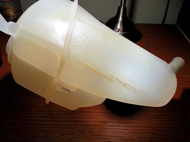

When the bottle gets hot, the cracks expand - hence the leak. When the bottle is cool, it's not uncommon to not be able to see any of the cracks.

YoungLs, take your degas bottle and hold it up against a light, you'll see the hairline cracks better that way.
It could potentially be the line fittings but the "dripping behind drivers front wheel" is a cracked degas bottle.

NOTE: we've recently seen a degas bottle split at the seam, which would be real hard to determine if it's partially split and leaking from there.
