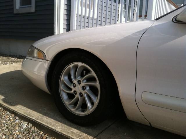

This started about 1-month ago. The front bags no longer hold air for more than a couple of hours. I'm most likely going to do a spring conversion as fixing the air suspension is more than the car is worth. I won't just need front air struts, my compressor sounds like a 50-year old refrigerator and I'm sure my rear bags can't be too far behind in leaking. Not to mention the suspension sensors and relays that are bound to break on my north east daily driver.
To add to my suspension woes I've got a front end clunk back again. I'm hoping it's not my upper control arms again as they've only been in for 32k miles and a little over 2-years. :(
Enjoy these familiar lowered (broken) pics. The last pic does look kinda cool............

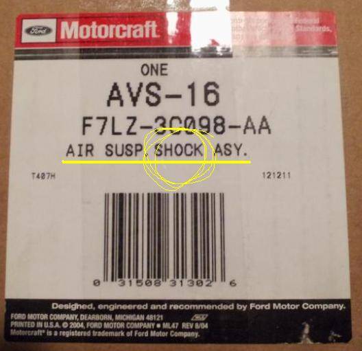

OMGOMGOMGOMG!!! You said it AGAIN:eek: I mean my gawd! Even Amazon knows they aren't struts!!! Come on!!!!
Okay:rolleyes: I'll get down off my soapbox now. I have to do this every so often. I know it won't change anything. People are going to continue to use incorrect terminology regardless of how many times they are told the correct term for a particular part. I don't understand it. It ain't rocket science. And don't think I don't know you used that incorrect term just to get me riled up. Others have done it before. Keeps the place lively:D

Once again, just for future reference:
