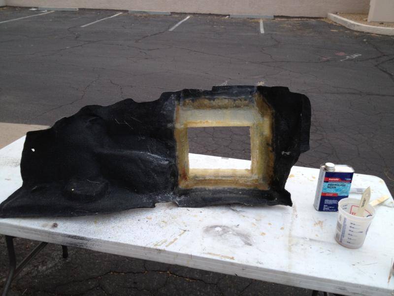

I plan on fabricating a "shelf" inside my spare tire well that's hinged so it can be "flipped" out of the way and still maintain access to the spare. There was another member on here that mentioned doing something similar (http://www.lincolnvscadillac.com/forum/showthread.php?85729-Fiberglass-Sub-Box-Complete!!&highlight=subwoofer+box see post number 15.) No pictures of his amp mount, but after I did some inspection and some measuring, I can pretty much imagine what it looks like. In fact, I'm basing a lot of my subwoofer install off this idea.

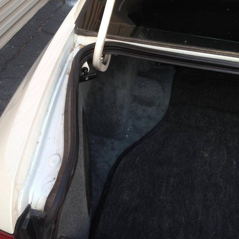

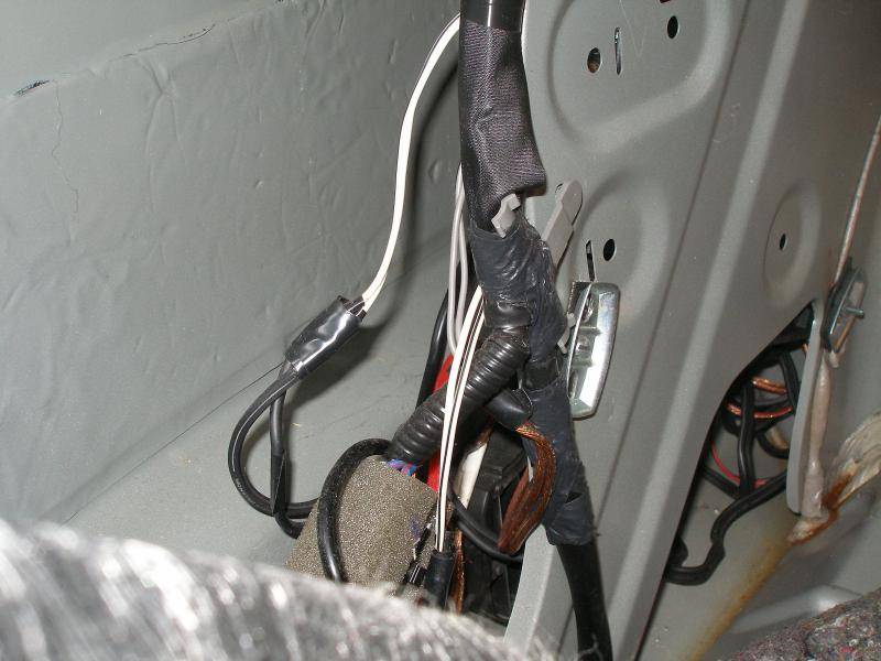

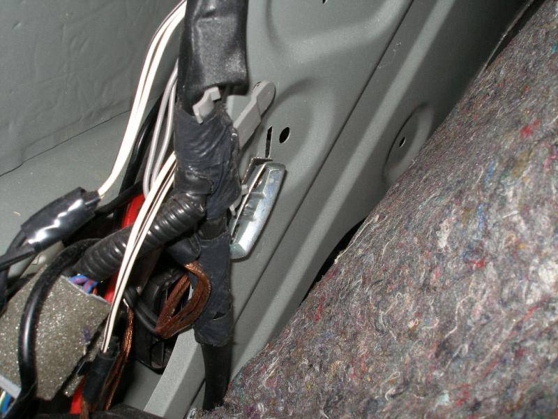

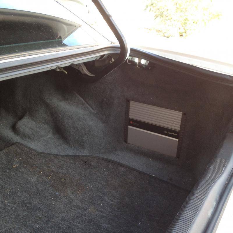

Look behind the driver's side trunk liner. There is a void between the outer fender and the inner brace. I mounted my amp there.
That is where the factory THX amp in my 2006 is located. I'll use this location for my aftermarket amp when I have to replace my factory system. The rear deck sub amp is tiny and is located under the rear shelf. I would not recommend placing a standard sub amp there.

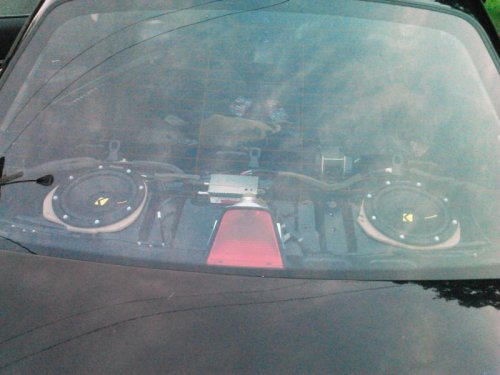

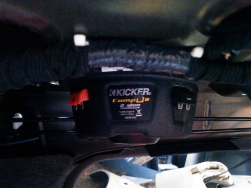

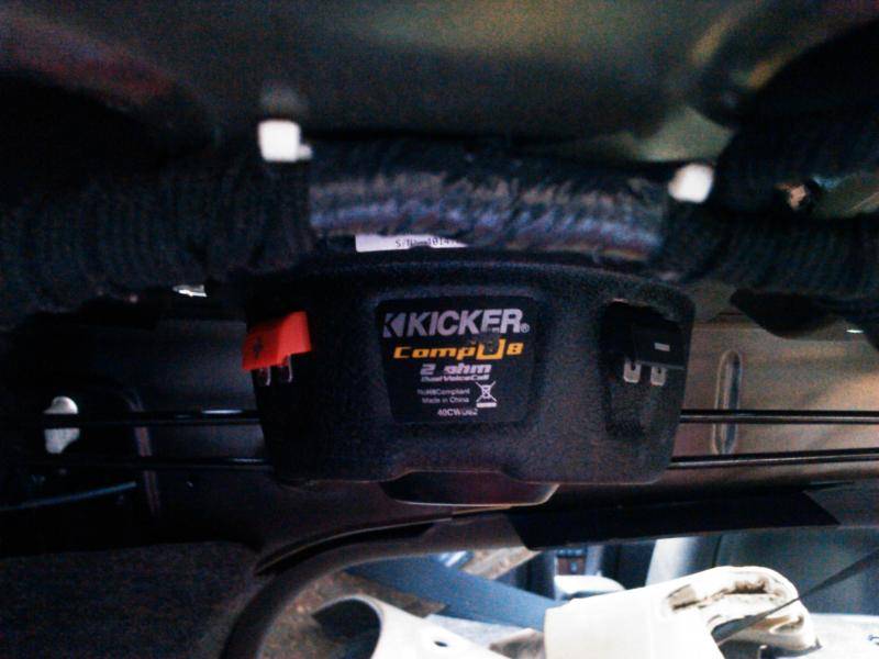

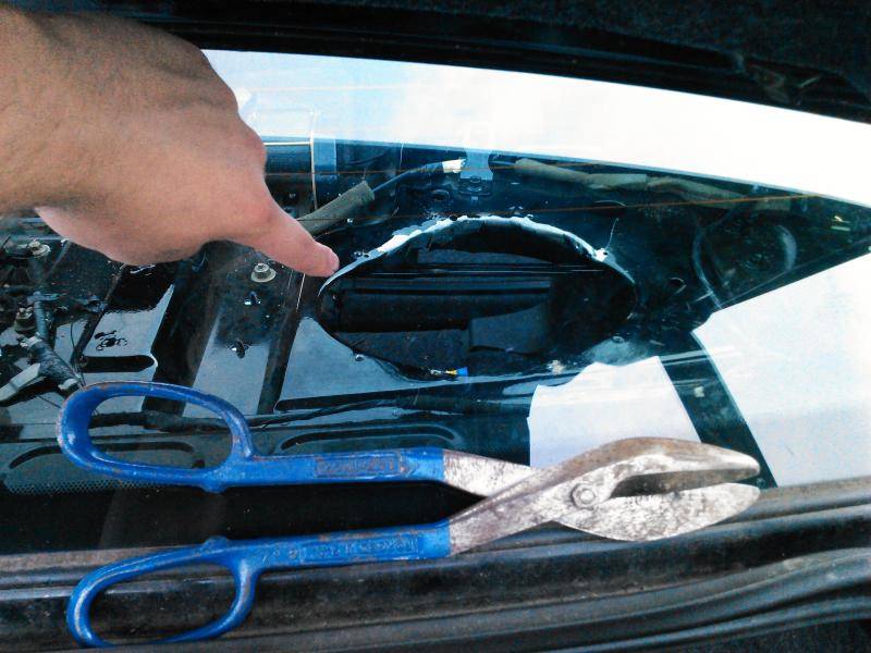

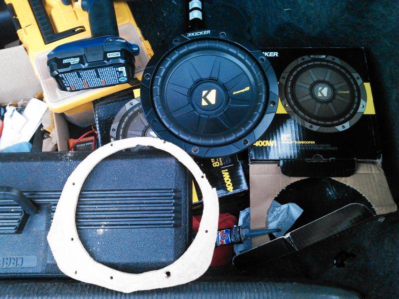

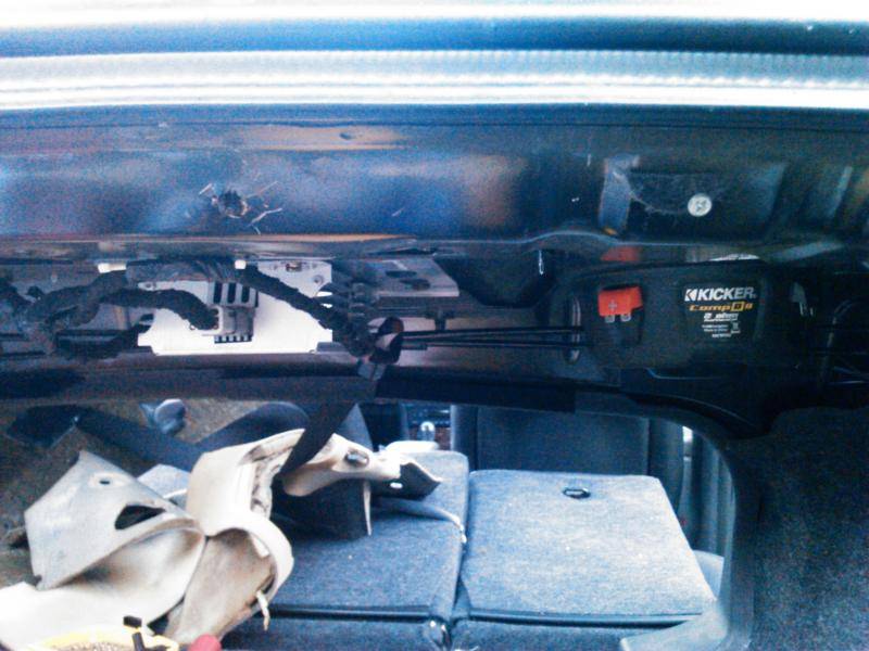

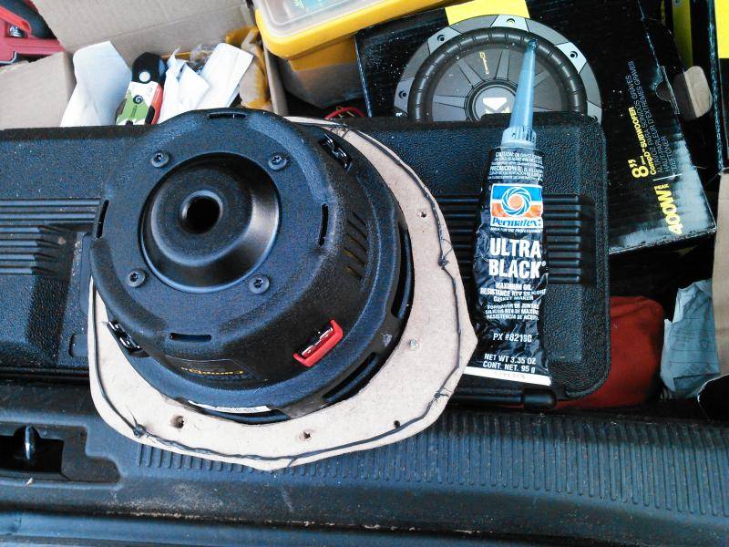

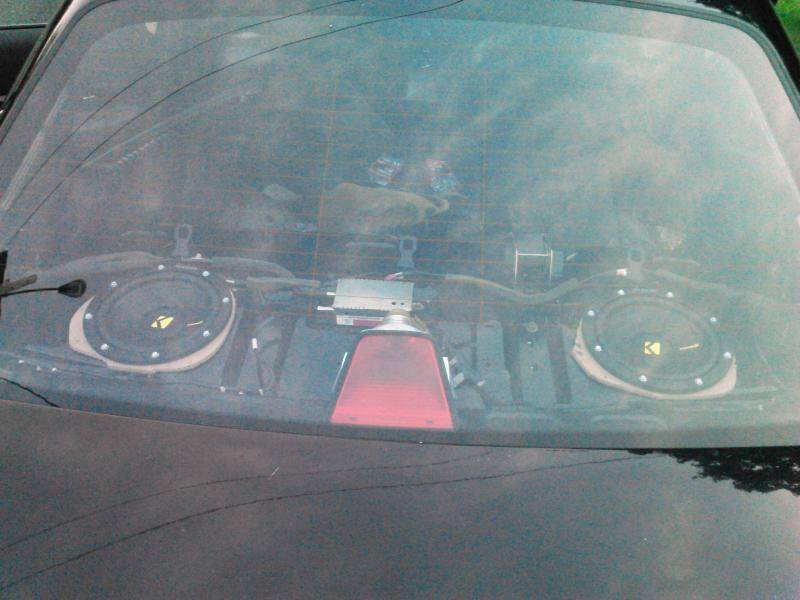

I went on CRutchfield, picked 8" and IB (infinite baffle, does not need an enclosure). That narrowed it down to 4 Kickers at the time, 2 SVC 2-ohm and 4-ohm, 2 DVCs. I only used a tin snips to cut strips and bend them down. Adapter is 1/8" MDF if I remember correctly. I'd strongly recommend drill the screw hole template from the bottom, not drilling with self-tapping screws and a flex-shaft through the top like I did.
I was very pleased with them with the factory radio and amp, but after installing an aftermarket radio, the lack of power is evident. The factory amp, as far as I can tell, is 85w total. I believe the factory subs were marked as 2ohm 45w. The Kickers are 200w. I picked the DVC 2ohm to give me more flexibility with the future amp. I'm guessing the factory radio tapered off bass frequencies as volume goes up for protection. This also seems to be the case in my Taurus with the factory Mach amp and a powered Bazooka tapped off the rear speakers.
With the adapter MDF, the Kickers are less than 1/2" lower than the factory subs. They still fit in the trunk liner

had a guy in the other day thinking about having me do almost exactly that in a first gen fusion with the sound system almost exactly like ours (except for the center console speakers).
I'm interested to see how you think they sound once its all hooked up!
How far down would it protrude into the trunk if you were to mount those things from underneath without enlarging the holes in the deck? I'm toying with trying something like this but I don't want to cut the metal. Right now I've got a pair of 4-way 6x9 JVCs that came out of my previous car. The baskets were just a bit too wide to drop into the factory holes from above, and the lip around the holes contacted the surround when I tried to mount it flush from underneath, so I took a 1/2" diameter wooden dowl, drilled out the center of it, and then used the bandsaw to slice off 8 little spacers 1/2" thick. I put those between the speaker and the deck with a screw through each and it works great. Of course, that lets air pass through the gap resulting in less bass, but a layer of HVAC foil tape around the edge sealed that up perfectly.
This is really a temporary solution for me because I know the 6x9s are a poor substitute for a legit sub, plus with the high-pass filter, those 4-ways are really going to waste!
Well, siht. I'm pretty sure I accidentally connected the sub to the front left RCA jack after doing some testing. Good news, though, I then turned off the high pass filter on the fronts and the subs started bumping pretty well (at least compared to the HPF set to ~100Hz). I tried pulling the deck out, but the wires are pinched and I couldn't get it more than half way so I can't check yet. This is just depressing because I did everything else fine. All the soldering, cutting, splicing, and programming, but not the RCA plug.
So 1LoudLS, when I open the dash for this a few other things (like correcting the illumination wire and tapping into retained accessory power), I'll get back to you
Does the center amp have it's own high pass filter? My deck doesn't have a center channel, just two fronts, two rears, and two subs. I'm going to make sure they're plugged into the front left.
Theophile, the adapter is 1/8", the sub ring is at most 1/4", and the lip for the 6x8 cutout is about 1/8", so bottom mounting them would probably be 1/2" lower, maybe 3/4" when you account for the surround's throw. That would put the 3-7/8" top mount depth at 4-5/8" bottom mount. They have pretty beefy baskets and the plugs are on the side, so I think they'd take the occasional impact from cargo.

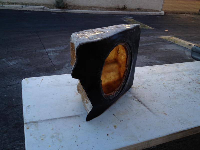

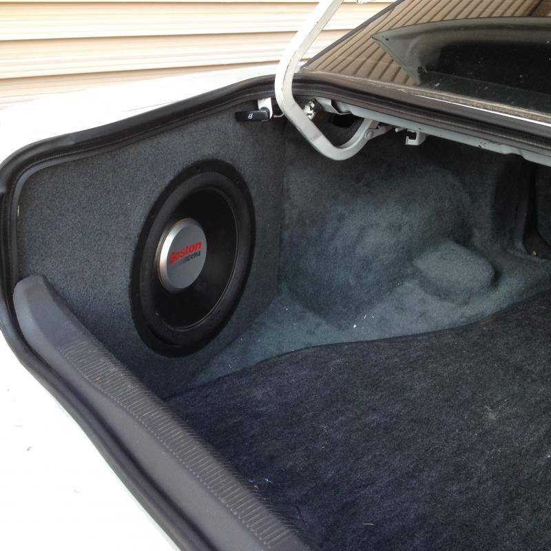

Here's what i did. Had plans to do this since i bought the car in 04 and i finally got around to it this fall. Boston G2 12 and Boston mono block totally out of the way. Im having a floor mat made for the trunk that looks like the interior mats. Should tie it together nice. IMG_1286[1].jpgIMG_1288[1].jpgIMG_1287[1].jpgIMG_0928[1].jpgIMG_0747[1].jpg
Its a little under a cube so i loaded up on some poly-fill. Boston recommends a cube for that 12.
That's nice, though I'd constantly be worried about cargo bouncing into it
I recall some custom fit ones for the LS trunk going around here and ebay a few years ago. I wish I would have picked one up now. How much do you think something like this would cost to have made? This is some pretty sweet work. That is the only way I will get my sub back. When it was behind the seats I bemoaned the loss of cargo space and crappy access to the spare and battery. I kept one of my subs when I upgraded to the '06 LS this year.
while every shop is different, around my area, you would be hard to find somebody that will build a complete custom fiberglass box starting under $300... while the materials are fairly cheap, the work itself is kinda time consuming and the shop still needs to turn a profit.
