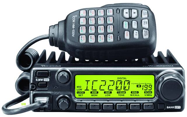

im having some serious alt whine issues. i just installed my icom 2200h 2 meter rig in the car and am having some whining going on. does anyone have the same issue, or have a suggestion?

yeah, this is the rqadio in there
