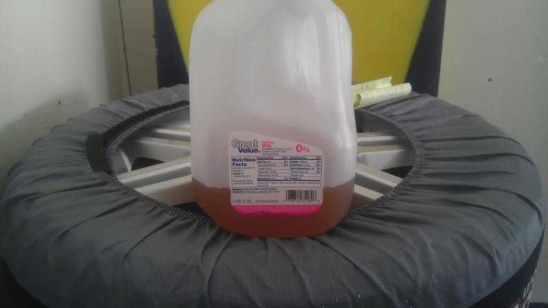

Just did the system empty, fill, and bleed waiting for it to cool down to top 'er off again. I had heat the entire time doing it once it warmed up. The steady flow of the bleeder wasn't what I would call steady flow, was more like a trickle. Didn't see anything leaking during the bleed process or after it was sealed up at the moment. The fan was not on at all during that entire process. Would that be my problem then, the fan not turning on?
Here's a pic of what I was able to catch in the jug. Probably overdue for a service, there's about this much on my garage floor as well. Not nearly the 4 liters that was mentioned elsewhere.
If you can afford it also do the updated idler pulley and tensioner.
