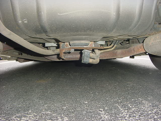

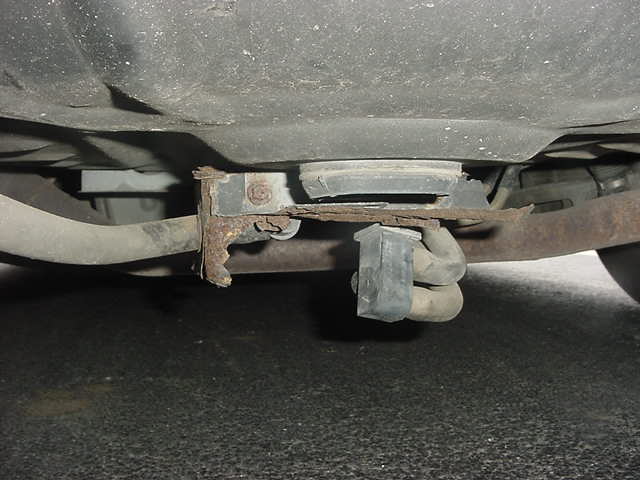

Where is the air compressor relay? That sounds like it might be it. The pump never comes on. I'll just replace the front air struts because the back never goes down just the front. Is there any way to check the relay for the compressor? And you guys never answered what that was that I'm missing under the trunk. Thanks for the help.

As far as whats missing under the rear, we can't see it from here, so without a picture or something, how can we know?

Pics
Here's some pics of what I'm talking about. It's has two rubber hoses on the right side that are just hanging there. The check Suspension light comes on a 90 seconds after I start it. Help!!
Thanks,
Adrian
Hopefully someone that owns a Continental will look under their car to see what that sucker is. ;) The big hoses look like no big deal, like maybe the vent tube for the gas tank or something.

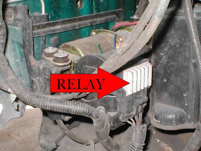

I thought I rememered it being on the drivers side, between the engine and strut tower, but according to ALLDATA, its right up front on the front valve cover. Below is a picture of the same "type" of relay your looking for. I DO NOT have a picture of the relay location on your car, this is a picture of the same relay on a Mark VIII. This is just to show you what it looks like.
The cheapest place I know to get a relay is through www.fastpartsnetwork.com Last time I checked, they're $89+shipping.

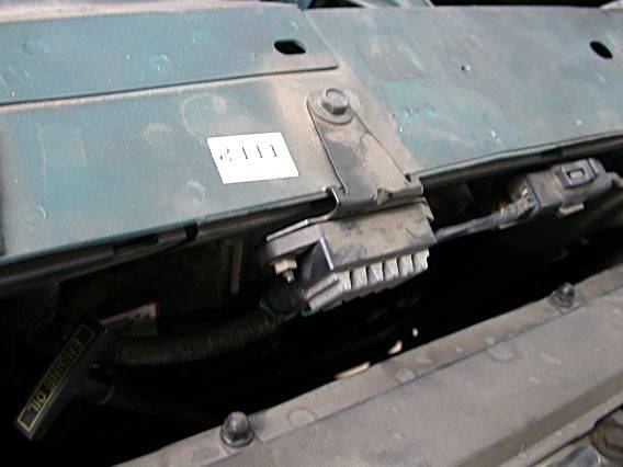

its attached to the metal L bracket on top of the radiator dead center.
oh and i might be wrong but i think you may have ripped off your evap cannister.

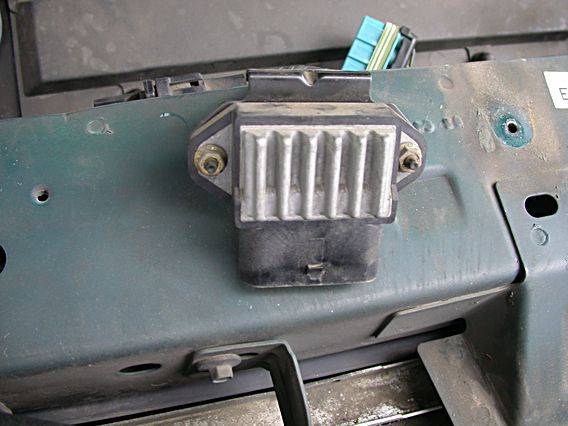

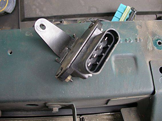

It sounds like I have the exact same problem as the OP. "Check ride control" comes on after 90 seconds or so. No compressor coming on. Bouncy ride. However, I do seem to have at least some air in the bags. The back looks a little lower than the front.
I tested my compressor today by hooking it up directly to the battery and it worked...
So now I want to try and replace the relay also.
Take a look at some of the pics I took today. I think that's the relay in question.
Can someone please confirm?
Thanks!
aristo1963 said:
hmm L bracket top center.yup that would be the one i described:rolleyes:
OK. Just wanted to make sure. :p
Is there any way to test that relay or does it have to be replaced?
Also, I've seen mention of problems with the wiring harness. Any more info on this? Where is it exactly? What should I look for?
if you jump the compressor to battery and it runs the odds are 99% its toast.cant be rebuilt and is dealer only.yard 10 bucks and up and you take your chances.dealer about 125 is avg.my dealer sold it to me for 85.good luck
