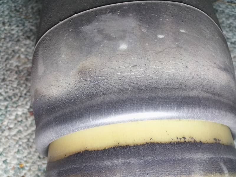

I have noticed all the front bag problems I have had have been from the fine cracking at the bottom of the bad where it folds over and has to roll up and down along the front shock body. Extend fronts and clean dirt,pebbles and such from the lower part of bag that ends up covering this crud at ride height. I would rub liquid silicon on the bags too, to keep them soft and pliable and clean.

Treat and condition the rubber with Zymol. I have done mine once since I bought them but they are new. I can't really say that I was cleaning them because the car rarely leaves the garage and is never driven in the rain. I'm just making sure I take care of these because it is a huge part of the suspension. I never use the "Rays Switch" except for the few times I have taken pics. I have spare rears still boxed up and conditioned and I am keeping the new fronts conditioned. I'm also spraying Armor All on a rag and wiping it on the plastic bottom half of the air shock so that it doesn't have a sticky layer on there. I may have wiped some dust away but if so, I never noticed any. They still look just like the day I put them in.

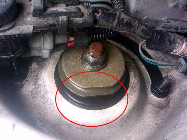

The upper mounts can be partially cracked and not leak. They were probably had a slowly developing crack that took a while to fully crack. It is a very common problem. You can also replace the upper mounts although you would need a donor shock. If you hoard good and bad shocks you are bound to have extra upper mounts.

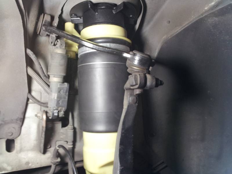

I recently replaced 2 of fronts struts with new OEM. I don't regret it and would recommend it as the best option on an older car. The ride is soo smooth and firm. Even though the old strut may not leak the shock part is worn out and gives that mushy feel people blame on it being an air shock. Back on topic, when you install a new OEM one you really notice how dried out the rubber gets. The new rubber bags are soo soft and supple. It gets you thinking about what can be put on there to preserve them. I will have to try out this Zymol stuff. anyone know of other good rubber preservatives.

Well, like Nolimit said, I replaced my front air shocks with new Arnott units a couple of years ago. No issues so far except for having to replace one under warranty due to a crack in the bag. I also have a set of used but great condition rear springs that I got from a member here. They're doing fine so far. I don't do the preventative maintenance I should on mine because I drive it every day and work a lot of hours and have kids and school and cub scouts and all that stuff. So I don't have a lot of free time anymore. But when I do have a minute I will liberally soak all four air springs with silicone spray. And if I have a few more minutes that I can actually take the wheels off and get under the car, I'll coat all four springs with a generous slathering of silicone grease. I can't afford to get a new set of OEM air shocks right now so I need to make sure and preserve the ones I have for as long as possible. And I know they're Arnotts, so I'm not expecting the 10-15 year lifespan of OEM shocks. But I'm going to try to make them last as long as possible:)
