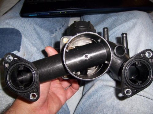

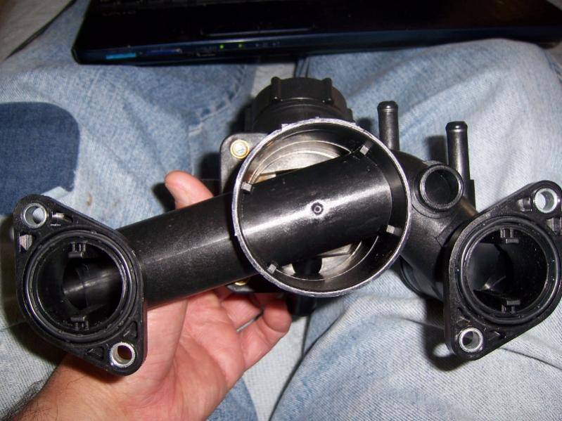

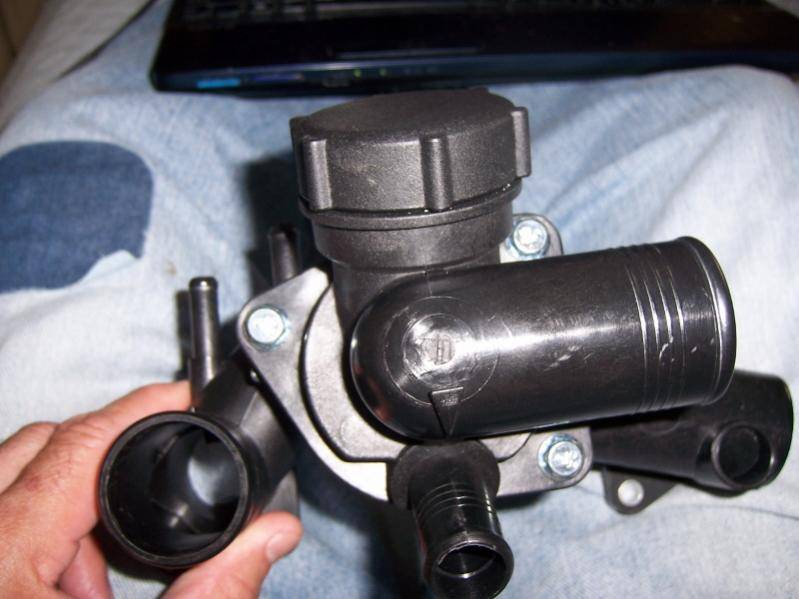

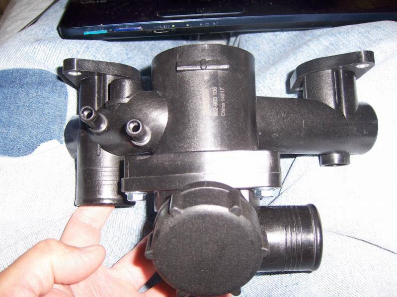

Well I got the Doorman upper Water Outlet Pipe/Thermostat Housing along with 1 interesting surprise.
First, the last comment talks about Doorman+Plastic = Crack in Seam... Must be talking about the water bottle or the Ford OEM Water outletpipe which does have a seam which does crack. This Doorman at least does not have any external seam in the failure prone area.
My impressions are based upon what I see today versus what I remember from several years ago when I had the OEM new part in hand. So comparisons and my opinion are highly iffy here other than general impressions...
The part Looks a lot like the OEM part. I would GUESS the Doorman is a bit shinier plastic and MAYBE just a little thinner in some places. This is HIGHLY subjective and guess work until I can compare old against new, and in any case I will probably never have the opportunity to compare New against new.
The shiney plastic makes me think it looks a little cheap and might be softer compound. I wonder if it uses FRP Fiber Reinforced Plastic like the OEM? It has swirls like FRP should so either it is cosmetic or they did use at least some FRP. The durability of this plastic will be under close scrutiny over time, but I am hoping I never have enough time to find out.
The bolts look like typical cheapo Chinese bolts. Not as bad as decades ago when they looked like some guy hammered them out in his backyard Barbecue. But they aren't the chemically treated bolts as OEM. They are maybe cheap chrome flash.
The metal hole inserts look good and the piece comes completely assembled(including surprise) and with the proper plastic "O" rings in place. All ya gotta do is pop the old one off and put the new one in.
The SURPRISE... This assmbly IS ready to go, it comes complete WITH Thermostat installed.
Based upon including Main pipe, Tstat Housing AND Thermostat this would cost a bit over $300 at the dealer parts counter last time I did this, it has been a while so don't know current prices.
So the question is... Why is a $300 assembly sold for less than $80? I suspect some of it is "you get what you pay for" and some is China can undersell anyone even with decent quality.
I am leery of CHina specials but will go with them if it is something that doesn't require precision and perfection. Since the Ford OEM part is also a pos I am more inclined to give the china part a try especially since it isn't hard to replace and I like working on cars for fun.
I am hoping this won't be like that old episode of Twighlight Zone where a guy wakes up in his apartment and even though everything "looks" Ok, it doesn't seem right. As he goes thru his morning routine he discovers that every thing he sees is as someone would see it, from the outside... There is nothing inside, like he has an empty cereal box, a phone with no guts a tv that is just a shell. Is the Doorman Wateroutlet in that episode?
Hopefully we will never find out and I will never post on this topic again, unless I discover anything of interest during installation, or it explodes on the freeway during 110+ summer heat.
Good Luck, I will need it,
Jim Henderson

I mean the slight tell tale line that is left behind by the seams of the mold that is used to cast the part. Ie Casting Flash, seam, mold mark, parting line, what have you.

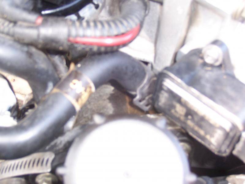

The key is that the OEM Ford part has a very visible line on the top of the central pipe that goes from front to the flange for the Tstst housing. That is where both of my wateroutlet pipes developed a leak which got worse over time. When the leak is "new" the OEM parting line "hides" the crack and it is not visible until much later when visible liquid, or staining or sometimes just invisible steam is felt blowing out. This process can take months until the leak is visible. At least in my two times at bat.
The ARE visible "seams" on the sides of the body where the two inlet/putlet pipes join to the body. I suspect if this part fails, it will be there. There are also seams on those pipes. Anthing cast will have mold marks unless someone does a cleanup.
Below are some pictures, of the Doorman part and a few of my old one still in the car. The leak can be seen as a brown stain line. I do not think the images are clear enough to see the new part seams but FWIW.
edit... Ah I do see some of the mold marks/seams in some of the shots.
