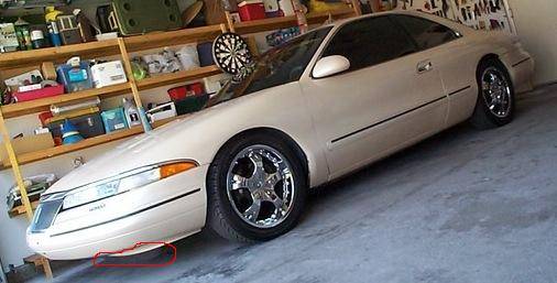

Do you have the plastic air deflector under the front bumper? This helps while driving, it forces air up into the A/C condensor & radiator. I know this to be true because my 95 was missing this part when I bought it. After installing it back onto the car the temp was reduced on the highway.
What is this deflector Turborich? and what does it look like? (i had my front bumper cover off a few weeks back and the only deflector things i saw were a black plastic flap by the pass side of the rad and 2 black plastic things just below the grille) Is this them? or is it something lower down? Curious...
Here is a pic of it. It runs underneath the front bumper cover. I outlined it in red. It goes along the rear bottom of the bumper cover, if yours is there you will know instantly. It's about 1 1/2" - 2" in height.
Thanks. Hmmm..... guess mine is missing that then! Lol. (i wondered what the plastic rivet things were for, at the sides, underneath) Hi - Jack over... back to Joey... :)
