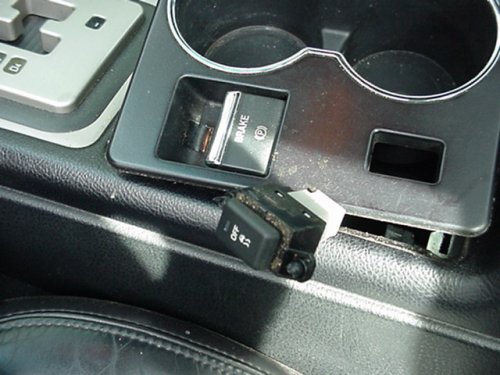

seems like more of a problem with light illumination trigger than a problem with the system ??
Also looks like somebody got a tad upset with it all and took their frustration out on the switch !! LOL !!
some epoxy and i can put it back :)

...seems like more of a problem with light illumination trigger than a problem with the system ??
I doubt that. The electronics in the cluster drive the light based on data received on the CAN bus from the ABS controller. It's not like it's a broken or shorted wire somewhere. If you come down to Gulfport, I'll pull the codes for you.
Nobody got mad at the switch. It's a pretty common problem. Both of mine broke, and we never even push them. (Epoxy solved it.) The E-brake switches break too. Go ahead and epoxy it in now. (Just don't get any on the moving parts of either switch.
