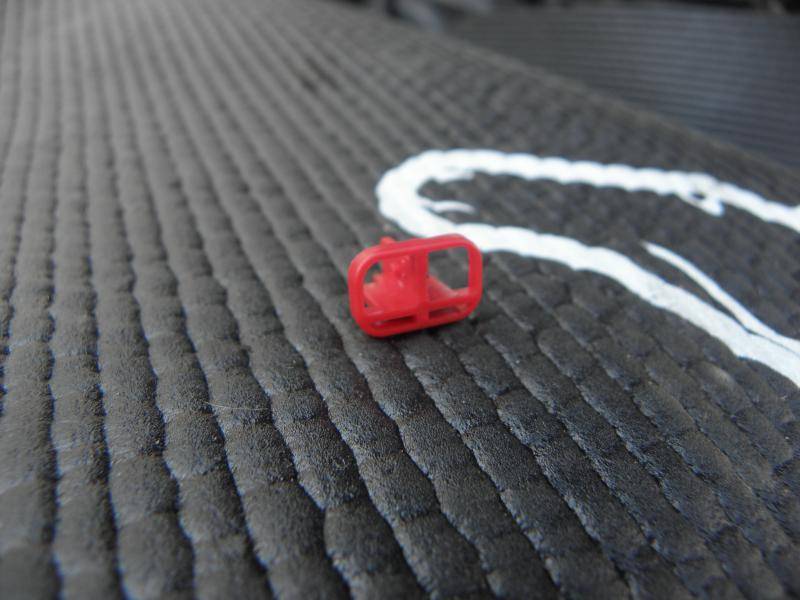

Alright, picture time. I couldn't find any help pulling the red clips when I did my Accel job. As a result, I broke 6 of the red clips. The first one came out fine and gave me way too much confidence in them just pulling them out. It wasn't until the 7th that I got the clip out intact. There's a set of replacement COP connectors on eBay for $40-50 I may try if I run into problems with them popping off or pins popping out, but so far (6 months, 3000 miles), so good.
Here's the red clip. See the smudge on the middle divider? That's the first bump. I used an eyeglass screwdriver between the red clip and black body to let it out easier

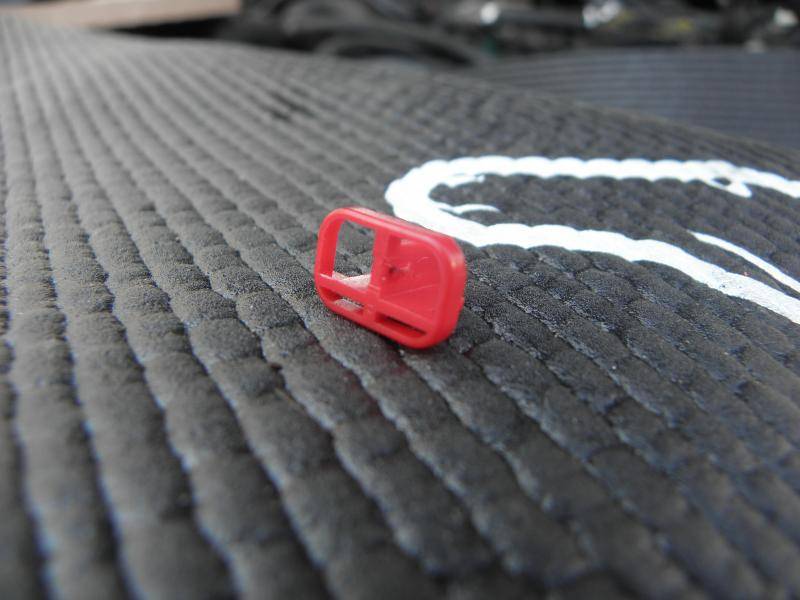

Here's the second bump. It's on the other side of the divider and is lower down. When you get the first bump cleared, the clip will out an 1/8". Same as the other side: small screwdriver between clip and shell.

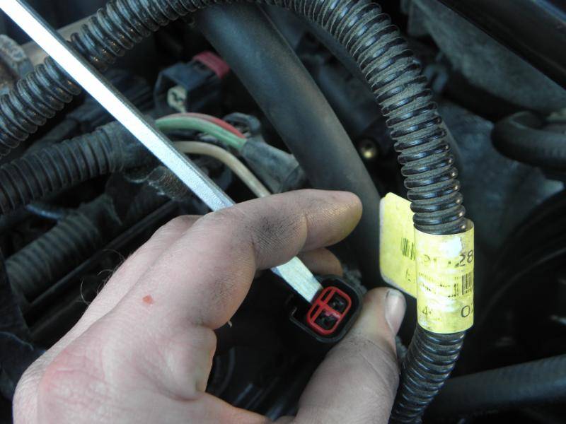

Here's what I did to do it successfully. I put a medium flat tip screwdriver under the clip and over my finger. This put an upward force on the clip, freeing me to just use one hand to hold it all and one to manipulate the eyeglass screwdriver.
