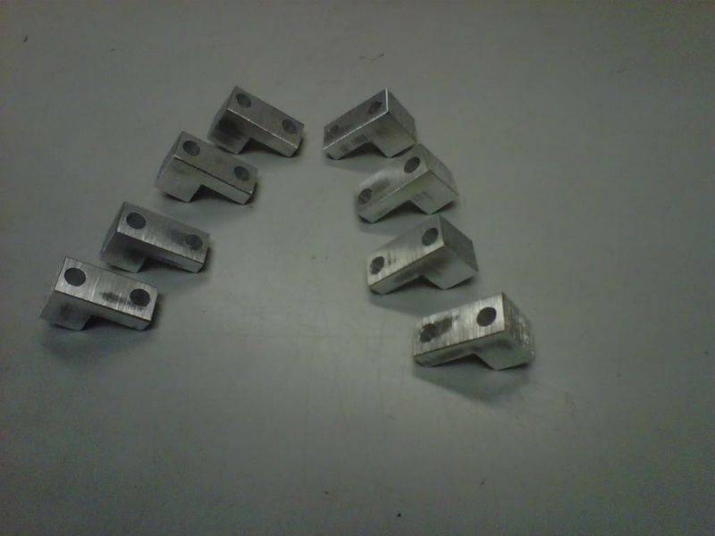

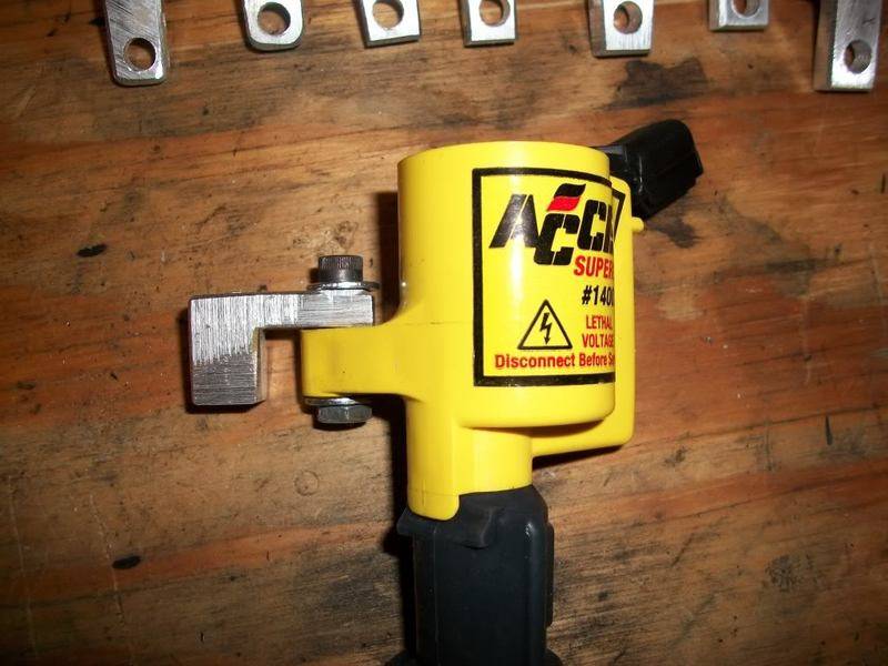

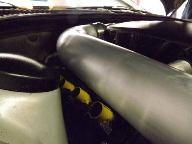

The only problem with fabricating a taller cover is the brake booster on the drivers side rear and the climate control duct on the passenger side rear. There is not much space to go any taller. I understand the desire for a cover but I believe it is better to have them out in cooler air. Brackets are $20 a set if anyone wants them
Thanks for the pics Hite. I'll have to order the coils to see how much can be increased.
Just putting the LS boots on them instead of using the 4.6 boots will drop them about an inch down. You would need a different retaining method other then Hite's brackets. I looked at using a piece of flat stock to hold them in place as well. That's still pretty much off the shelf, just mixing parts and have one custom retaining bracket. This only works if you ARE going to have some sort of sealed cover though.
