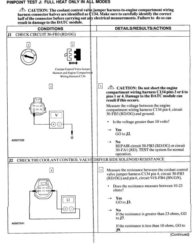

Help testing DCCV
Hi,
After replacing the DCCV twice but it still doesn't work, I would really like
some help testing it. The DCCV does have 12V power, but it is still not closing
when the AC is turned on. How can I test that the DATC is sending the correct
signal to the DCCV to close when the AC is turned on. I'm going to just replace
the DATC since that is the only thing left that has not been replaced. When I turn
on the AC and let the car get hot, I check the hoses going into the firewall, and
all 3 are hot, meaning the DCCV is not closing to prevent coolant from flowing
though.
Any help would be appreciated. I have fixed every problem with this car
except this, and I'm not going another summer without AC. I'll give it another
month, then I'll just suck it up and take it to the dealer if can't figure out why the
DCCV is not working correctly.
Please, if you have any ideas they would be greatly appreciated.

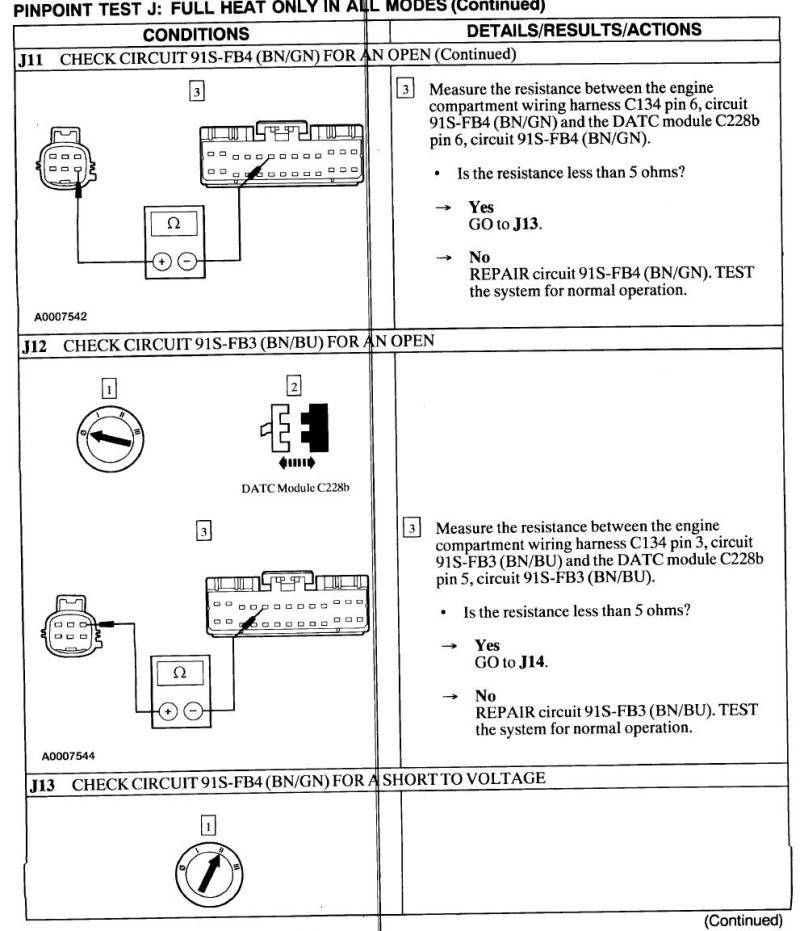

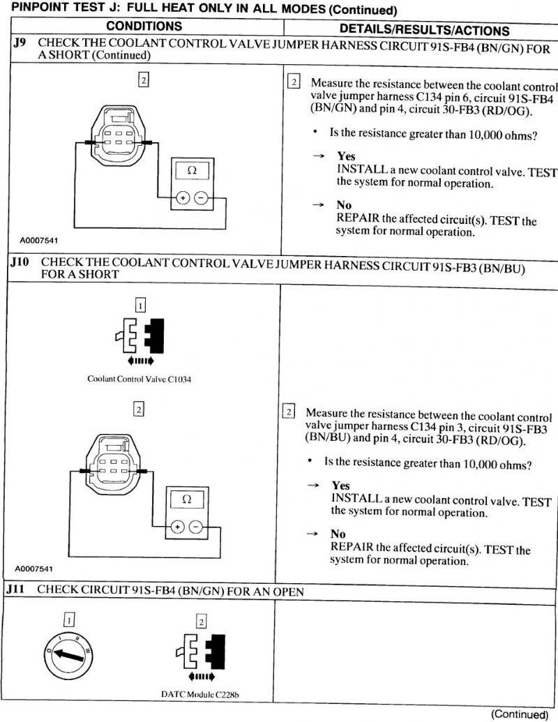

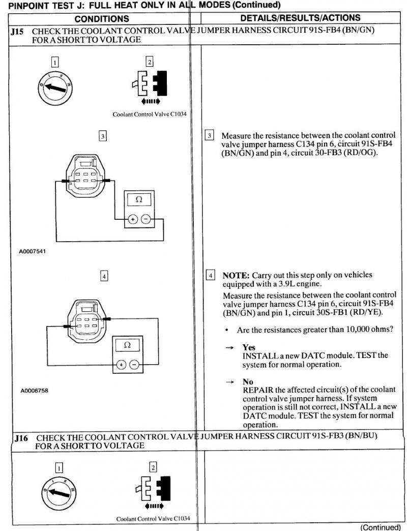

It could be the wiring to the DCCV, the DATC, or the temperature sensors read by the DATC. I've seen or heard of the DATC causing this, and of the evaporator temperature sensors causing this. If you have a good scan tool with live sensor readings, you can call up the evaporator temperature sensors and see if their readings are sane. You'd also want to look at the in-car air temperature sensor and the exterior temperature sensor. The exterior sensor is easy, since you can display its reading on the DATC.
I assume you have done the DATC self-diagnostics?

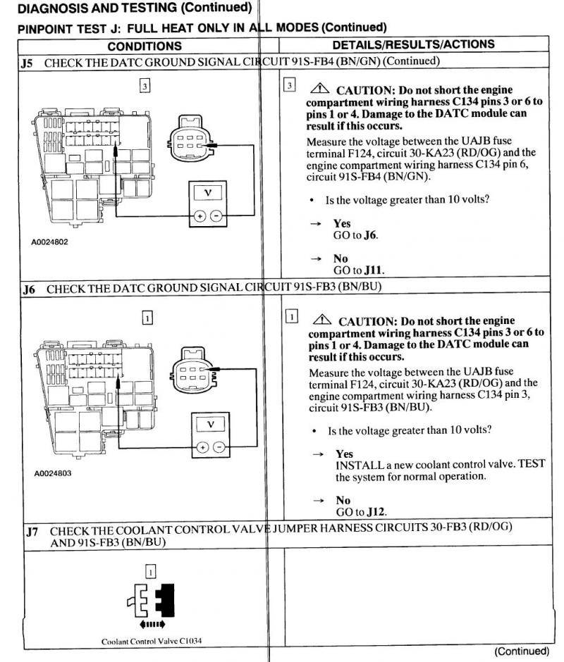

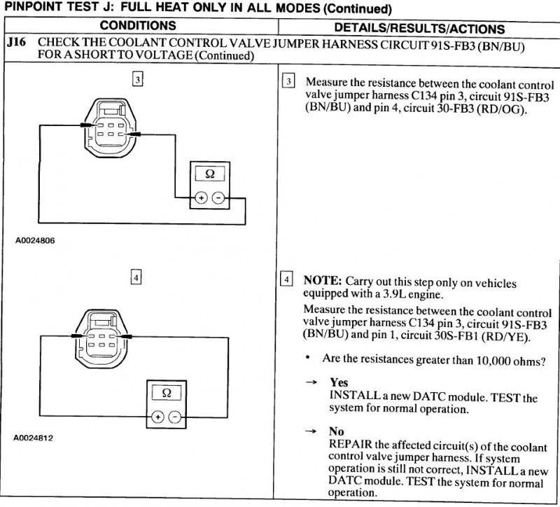

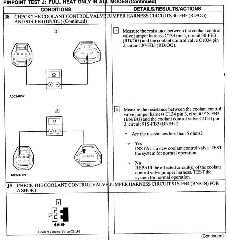

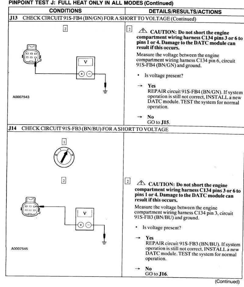

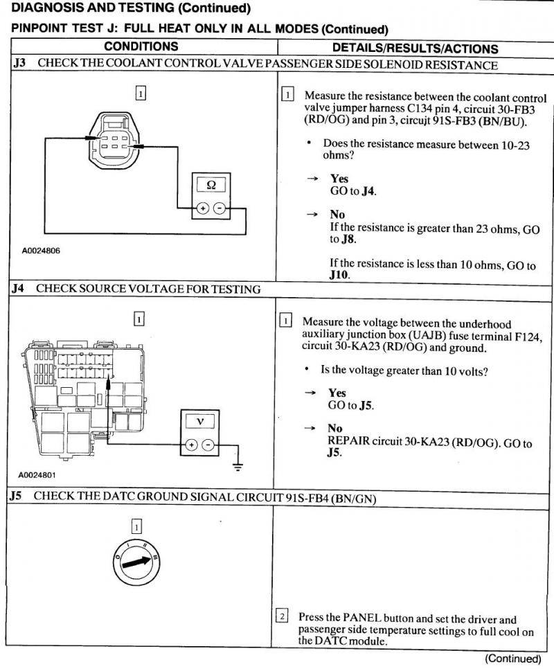

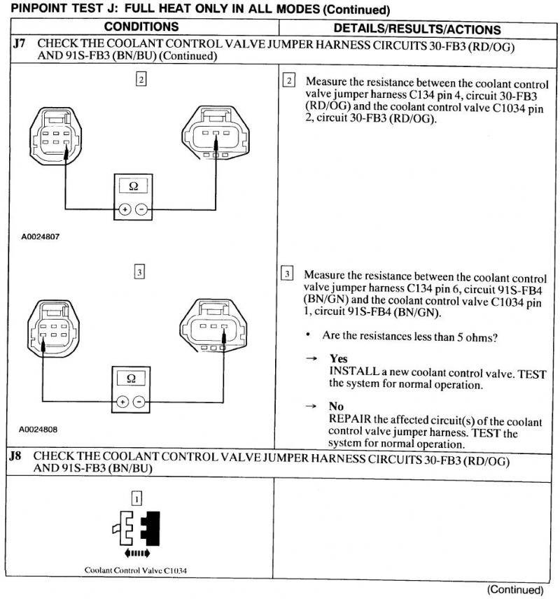

I have procedures to test the wiring, but I don't know what year your LS is.
my car is a 2000 LS V6. I think what you were saying joegr is on the right track.
I know the DCCV uses 12v power and when the AC is turned on, it should send power to the valves to close them. I'm just not sure how to test for it with the voltmeter. Also, I have checked for codes on the DATC and it shows none. As for the evaporator temperature sensors, I have no idea how to test those since I do not really have much testing equipment. But I think you are on the right track. It figures i would get the most difficult abnormal problem. It couldn't just be the DCCV.
Gen I DCCV wiring tests

So after pulling most of my hair out, I now have AC. After all the trouble, it was
the DATC. I had replaced the DCCV twice, vacuumed and recharged the 134a refrigerant, and replaced the drier. I was at my wits end since nobody seems to
have my problem. So I picked up a DATC from ebay for $70. I put it in yesterday and voila. Cold air. I can't believe it. Thanks for everybody's help getting the testing instructions.
