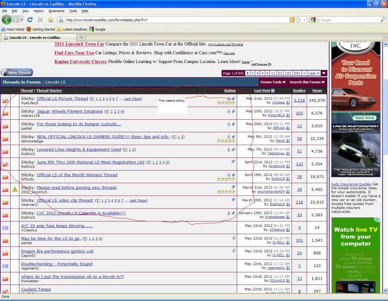

    I dont mean to sound ignorant, but what do you mean by reading the stickys? I am new to posting on forums, lol
  6. Hawk03
    Hawk03 Dutch User
    Messages:
    1,005
    Likes Received:
    4
    Joined:
    Apr 17, 2005
    Location:
    LS
    Sticky at top of forum.
