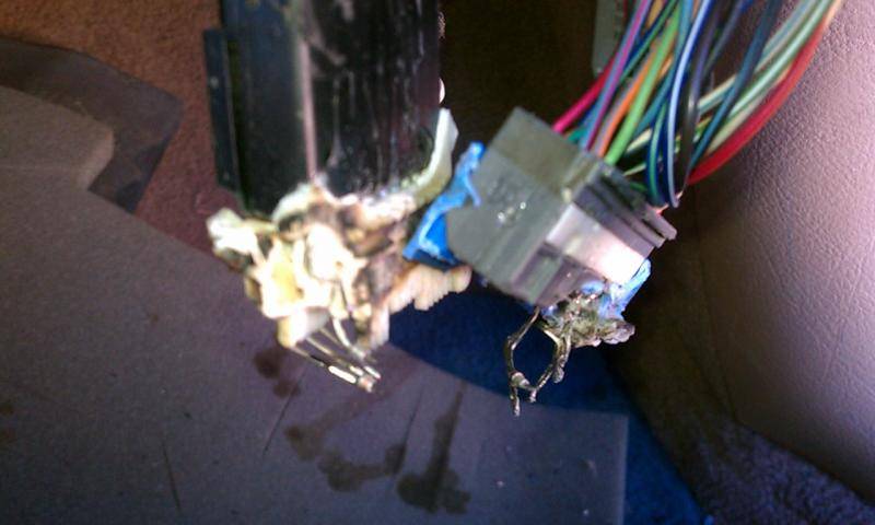

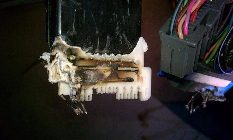

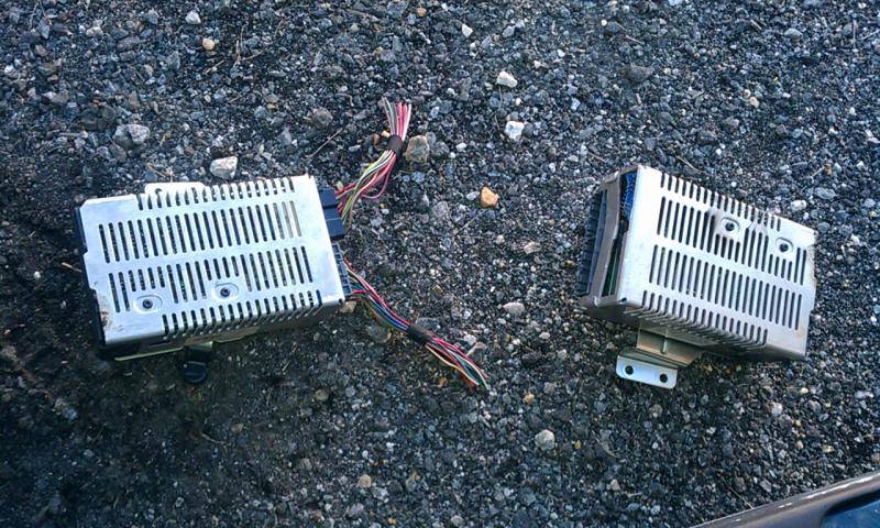

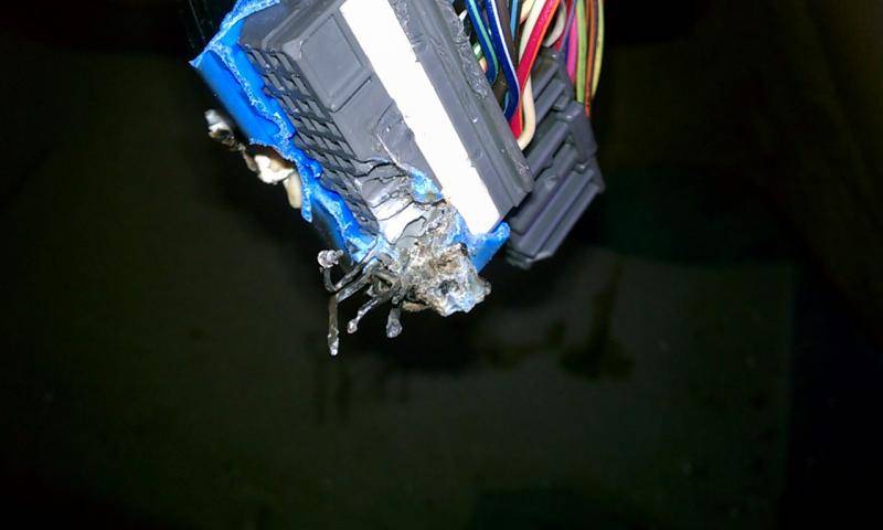

ok, so i went out and tried to see what the scil thing looked like... no dice, its in as bad a shape as the tail light ballast. i think it was amazing that the car was running giving the shape of it. i have questions now, the thing definitely shorted out, but none of the wiring looked melted. i unhooked the batty and unbolted it gonna pull the wires and 2 of the connectors are stuck in place, it looks like they fused pretty much... gotta love this fancy stuff. anyhow, im gonna ride back to the junkyard and see if that parts car my lights came off of has this thing and not burnt like mine. my question is, if i cant remove the 2 plugs, is it safe to cut the plugs off the other car and just cut mine off and splice them together? or should i try and try to get thing unplugged and only cut as a last resort? i have pics and am trying to get them uploaded. thanks
pics
here is my scil? looks like my tail light ballast, no wonder none of my lights work...
Looks like your SCIL shorted out for sure. I have one sitting on the shelf. You will definitely need it. Your key will need to be reprogrammed to the new SCIL. That's the first time I've seen one short out like that.

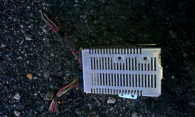

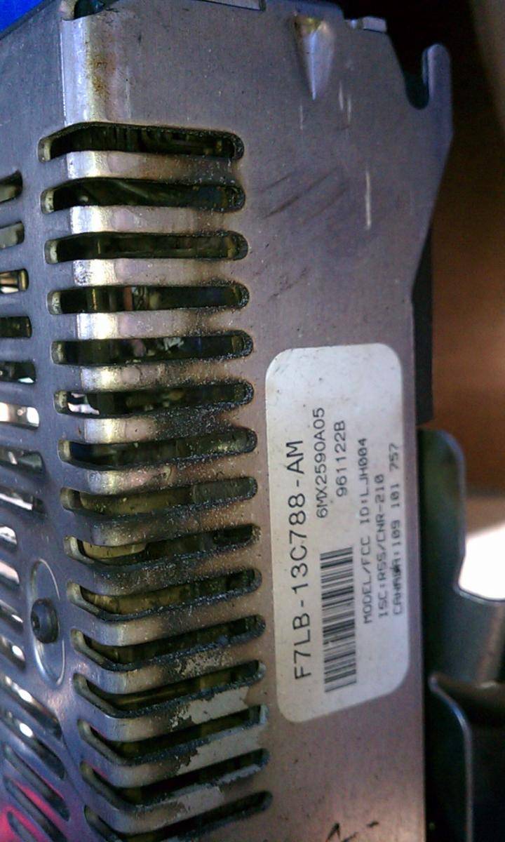

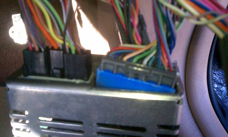

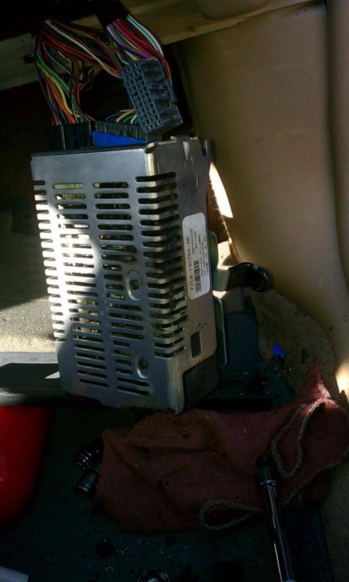

ok, just got back inside... the car is stock everything, not even any aftermarket stereo stuff, so dunno? i went back to LKQ and bought the scil out of their car and just finished temporarily installing it. i am doing the key relearn (courtesy of bluebmw83 thread on reprogramming the key to different scil) and am on the first of the 3 15 minute cycles. all my lights are working normal now except the center tail light, maybe its a bad one? but my flashers are working, the indicators on the dash are working and i all the headlights but the d/s low beam. i have pics of the new used scil and of the old one out of the car and some of the connections, lets just say that i have the best bad luck, because i took this car down the road yesterday and omg, its amazing it didnt burn to the ground! hopefully my experience can help out someone else in the future...
