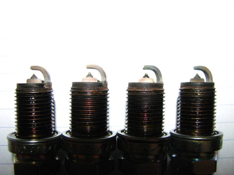

Unity you mention these cars using two different plugs. My manual only lists one plug and I just pulled my plugs and they’re all the same. They’re also likely from the factory.
I believe only the dual-output coil Marks requires two plugs. Makes sense, as the spark only goes in one-direction in a dual-output and wears each plug differently.

If they are factory plugs, one will have yellow markings the other blue. Not sure what you mean by dual-output coils. But ALL marks are wasted-spark setup. While the COP version may have more effective coils, they are still fired in pairs - this I know all too well because I covered a 96 to COP from coil packs. Still used my same computer.

The COP system on a Mark is wired in series. Remember, the PCM directly initiates firing on ODB II (1996 up), not a separate EDIS box and there are only four triggers. In theory, the same computer can run a four cylinder setup. I had originally wired my COP conversion in parallel as it "made sense" at the time. The car never ran. With limited knowledge by myself and those online (no one could figure it out) I re-wired to series and it instantly fired up. A year long project with a swap to a 2004 Aviator engine was complete. As for polarity, that would change because now there are two components in series.
If I recall, one side was platinum the other double?? Using two different types was maybe a cost saving plan? Making thousands of cars, every dollar counts. Just like fleet fuel economy stuff. But when purchasing new, I think they are all double and the yellow ones were only put in at factory. Factory, two parts for plugs but replacements under one part number.
Note: "One half of the spark plugs fire from the center electrode to the ground electrode and the other half fires from the ground electrode to the center electrode. The EEC fires two spark plugs simultaneously. One spark plug on the compression stroke uses the majority of the coils stored energy, the other spark plug on the exhaust stroke uses very little of the coils stored energy. This is the reason why you may have found AWSF-32PG and AWSF-32P plugs in your 1996 and later 4.6L vehicles when changing spark plugs. Only half of the plugs will wear out faster than the others. Ford only needed half of the spark plugs to be full platinum, so this was done to save cost. The replacement for these are AWSF-32PP, or 8 double platinum plugs. Later on Ford changed their suffix designation on the platinum plugs to “EE”."
