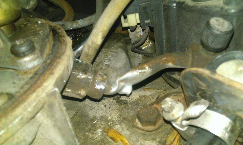

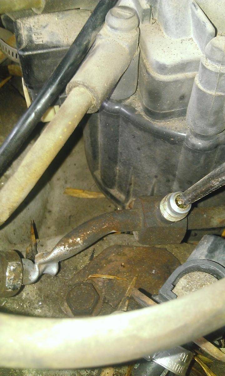

Ok I took off lines from carburetor and,cranked her over and no,gas came out of the one line and the other one,appears to,be twisted from a previous attempt and ripped. There is no gas getting to the carb and one of the fuel lines is like torn at the tip where you turn the two nuts to take it off. Is this sounding like the fuel pump,or filter,again?
Self explanatory.
The empty line is the return line. The twisted line is the feed line. You need a replacement fuel line at the throttle body.
Watch the video on disassembly, do it just like that. He probably ruined it trying to do a throttle cleaning service.
wow! that turned over at least once. See that cap there? In line with that tube? Remove it. Press down on the valve. If it sprays fuel on your fingers then you know fuel is getting to THAT point. That is the pressure relief valve for the fuel system. You should have pressure because the pump is working. When you depress the valve the fuel should spray over your fingers, watch your face you dont wanna get gas in your face.
And now you know which line to replace, the fuel feed line with the Schrader valve on it. Now the hard part is WHERE to get it?
Ok I cranked over motor and push on that pressure release valve and nothing is coming outta valve no spraying gas pr anything
