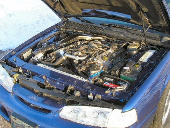

I can't remember the dimensions... but there is like .5" between heads and the frame in a Mark.
I've been told that with a modified 4.6 intake it will fit under a stock or smaller cowl hood.
that was in a Tbird. I've seend a couple of pics of the swap done some look really good. others are a real hack job

i have been reading a little more into the 5.4 DOHC's and according to a guy in the link below. if you use the intake that the guy used in the pic of the white mustang in the link in my last post the 5.4 DOHC would only be .75" taller the the 4.6 DOHC and it is only 1 5/8" wider. i think it could fit but it would be very tight. i was looking into doing this swap a couple mounths ago and people said it would not work. but it just may be time for me to revist the idea:)

first, its not the height of the intake that is the biggest prob, its the added DECK height (top of cyl) pushing the dohc heads farther out, that plus exhaust equals no room
second, stop comparing our eng bay to a mustang, 2 very differant cars, if your gonna compare it to something use a bird for example, seen any dohc 5.4 birds.....nope
third, as far as just bolting your dohc heads onto a sohc block, uhh they could work, just need alot of other components, front cover, not sure about the timing chains, have you ever timed one of these things PIA!!!!! quite a few specialty tools to line it all up
forth, i dont mean to come off like a ass, just trying to help you from getting into a never ending mess :D many have considered this swap all to learn it wont work out in the end
Yeah, our shock towers seem to be a lot more intrusive than those of the SN-95 Mustang.

I have seen a DOHC 5.4 Tbird. it was tight and the shock towers had to be knotched. alot of work? well not really once you have the motor out.
