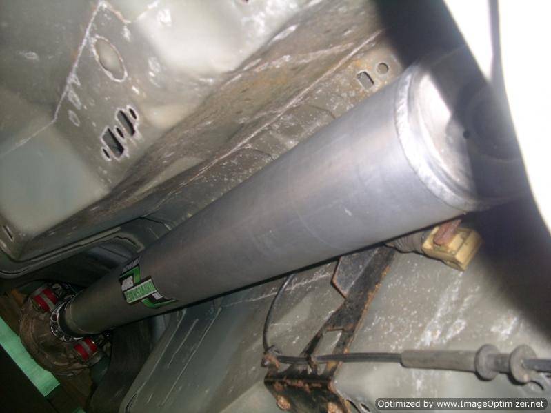

here's the D-shaft, basically a mustang driveshaft...

Dig the 1 pc driveshaft. Sure looked like a tight fit when I mapped it put. Looks like the center bearing framing/structure had to be removed, didn't consider doing that. With a hard shift program I can feel the 2 piece and/or Guibo bounce, not bad but I can tell and that would surely fix it. Have to take it highway speeds to see if it "smooth" not that it won't be.
Yeah she was tight. Removed the carrier support, also had to remove the shifter and heat/bend the lower metal part were the cable connects because that was on the shaft too.
The output of the tranny is a mustang flange as well. I didn't want the shaft so big around just because I knew there wasn't alot of space to begin with, I wanted like a 3" shaft, but anything over 60" I think he said has to go bigger in diameter.
