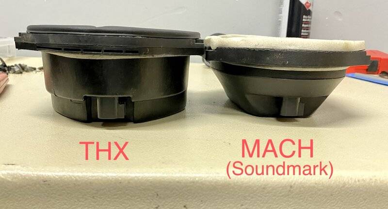

I replaced all my door speakers with THX speakers from another LS at the boneyard, also $5 each. I swear I remembered reading other posts stating the THX and non-THX door speakers were all the same — but they are not. I didn’t weight them, but the THX are probably 1.5x the weight, and have a slightly taller non-chamfered housing, but still fit just fine. The THX speakers have a good bit more of a punch, probably on account of the bigger magnet - the actual cones/tweeter appear very similar, if not identical, though I did not pull them apart to inspect.
Attached: Comparison of THX and Original Soundmark/MACH door speakers. I replaced the cruddy foam seal with rubber stick-on weatherstripping I had lying about. The white on top of the MACH speaker is replacement foam stick-on insulation I had lying around last time I pulled the speaker out.
