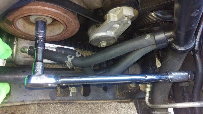

...Curious, I'm imagining that I'll need to hold the crank somehow for loosening and reinstall. Is there a slick backyard trick for this, or will I need to buy a 3.9 specific flywheel lock?
There is no lock. You'll damage the flexplate if you try to hold it from that end. The factory manual says to use a chain wrench on the pulley.

There is the generic trick of using a long socket handle wedged against the ground and bumping the starter, but that one makes me nervous.
I've done this three times now in my life and all three times I was nervous as hell!
The third time was today, I could not get a good grip on the pulley while changing it out so I resorted to this trick again.
I had planned on using my breaker bar but could not find it... will be taking that up with my sons when they get home from an out of town drift event this weekend… so I used an old torque wrench that I've had for who knows how long. It's missing the end dial lock piece on it anyway. I also did not, nor have I ever used the ground, always the frame rail. In this case there is a hole that worked perfectly for this.. Using a short extension, an adapter and a shallow socket ended up spacing it out almost perfectly and the length of the handle was just what was needed.
The following pic is post starter bump and after I removed the old towel that I used to support and keep it in place. Not that it needed it because the socket fit so well that it did not even try to fall. But a little extra support can't hurt. All it takes is the absolute minimum movement of the starter.
Oh and yes I did see the clamps and they have been fixed. Funny thing is that as many times as this has been to the dealer for RM, no one has ever fixed or even mentioned it before.

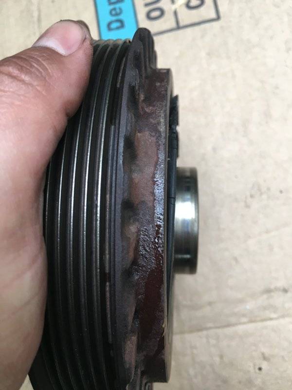

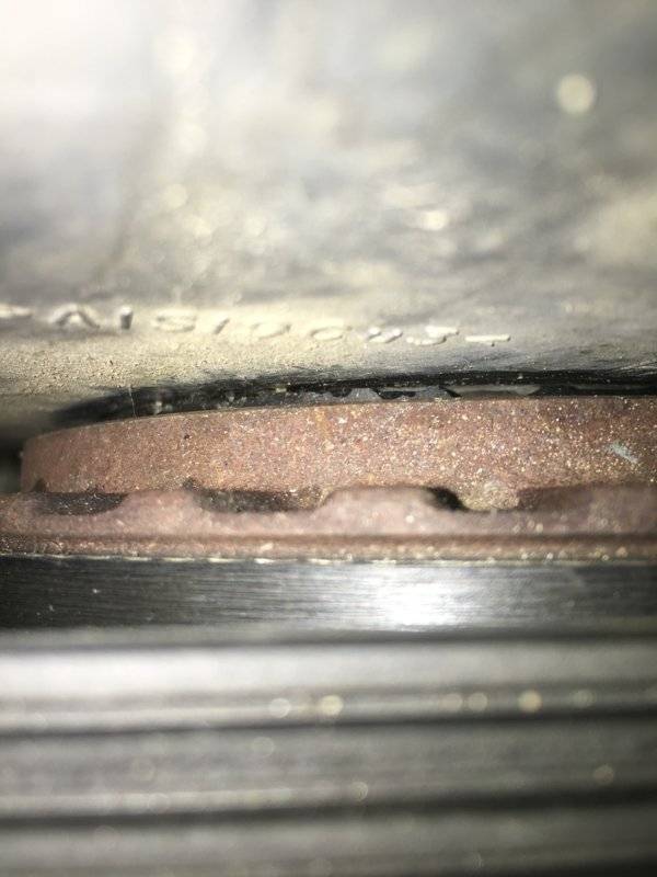

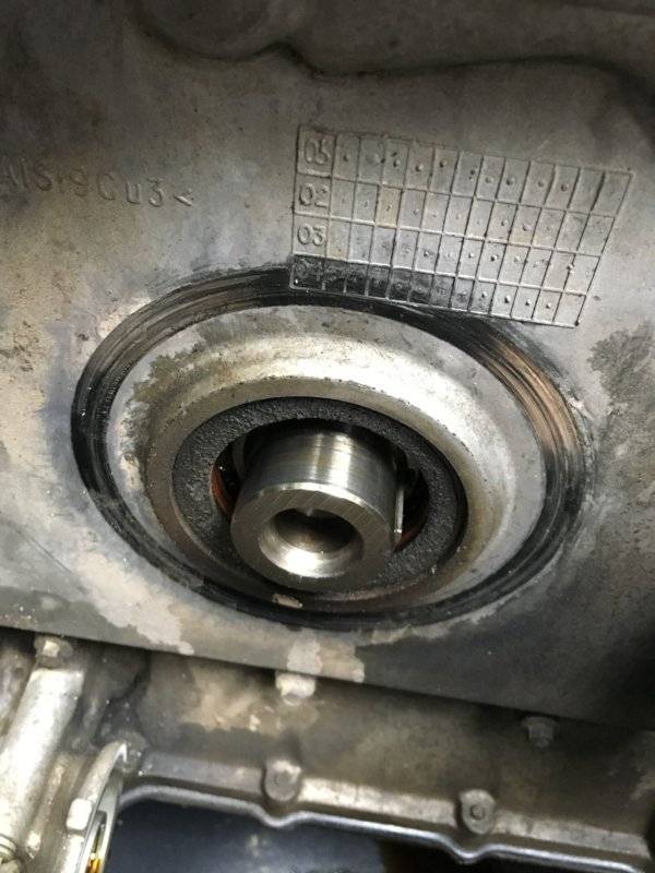

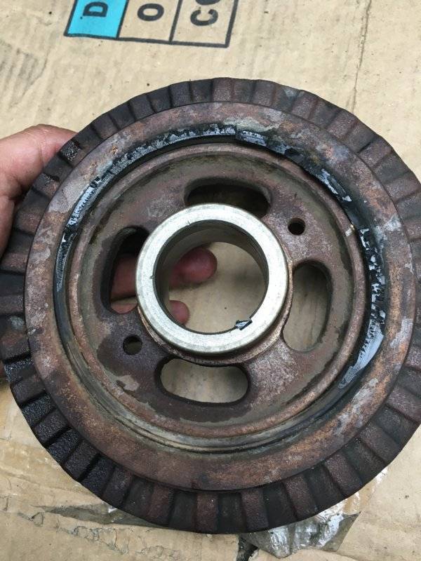

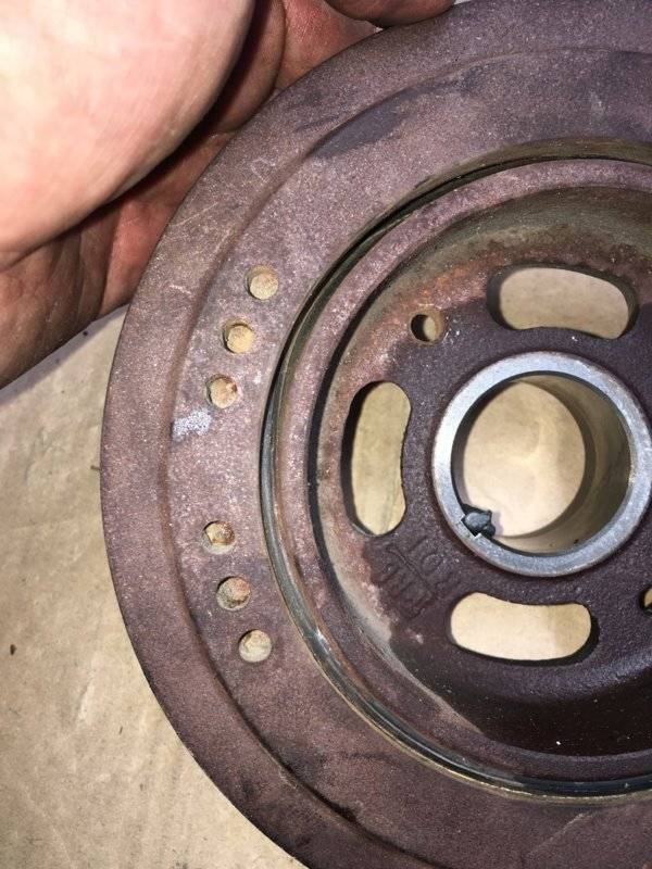

I have an 06 with 125k miles. I turned the engine on today after changing the oil and I noticed the harmonic balancer does not run true. I wouldn’t call it a wobble, but I can see how someone else would. No noise or issues, but the belt did have a groove that looked like it was worn. The belt has about 15k miles. I changed it last year. Is this a sign that I should change the pulley?
Thanks joegr. I decided to swap it out while I overhauled the cooling system. Figured it’d be easier to do while I had the radiator and intake off. I found one from a 2005 with 170k miles for $30 shipped. I got lucky I found it
and just in time. Looks like the rubber was acting like the lobe on a camshaft and that’s what was causing it to wobble.
