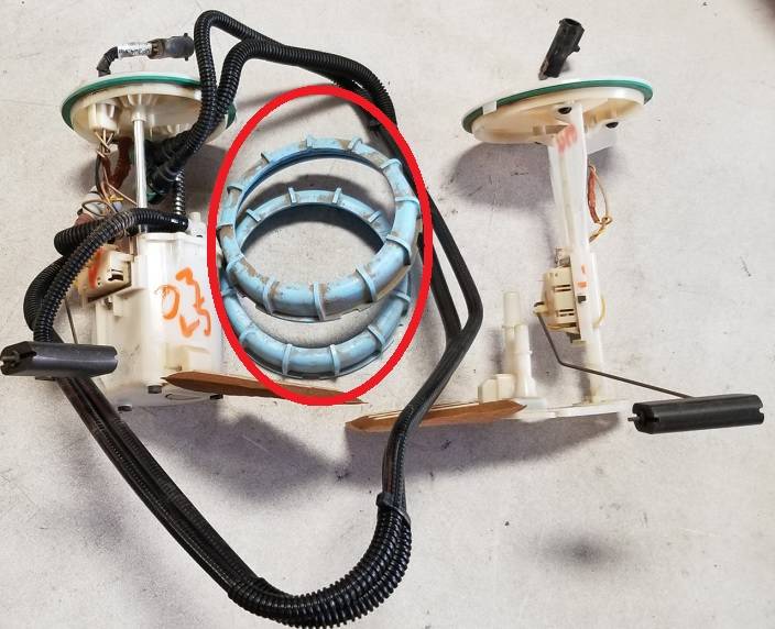

The big red flag is your symptoms AND the previous owner "changed" the fuel pump. You need to remove the back seat and see if the guy broke the ring or other plastic parts in that area. Here is the fuel pump assembly and I have circled the plastic retaining rings that hold the pump assemblies into the tank. I see you have inspected the area but I would remove the retainers and pull the pumps to inspect it all.
They have seals (Green seals in the picture) and the blue plastic rings can be broken as well but there is a special tool to remove them. IF your careful I have tapped the rings loose using a small punch but be aware this is now all old plastic and is fragile. Many times the hose connections on top are messed up too.

Next it sounds to me like they dropped or left some hoses dis-connected inside the gas tank. The car has a fuel pump that also runs what's called the jet pump. This allows the system to keep both sides of the gas tank even. The jet pumps only function is to pump gas from one side of the tank to the other. It does not pump fuel to the engine.
What happened to you is when the hose or hoses to the jet pump have been unhooked or screwed up in some way. Your effectively running on only half a fuel tank. People have lived with this for years by doing what you found out. Keep the tank full and you will never see that problem.

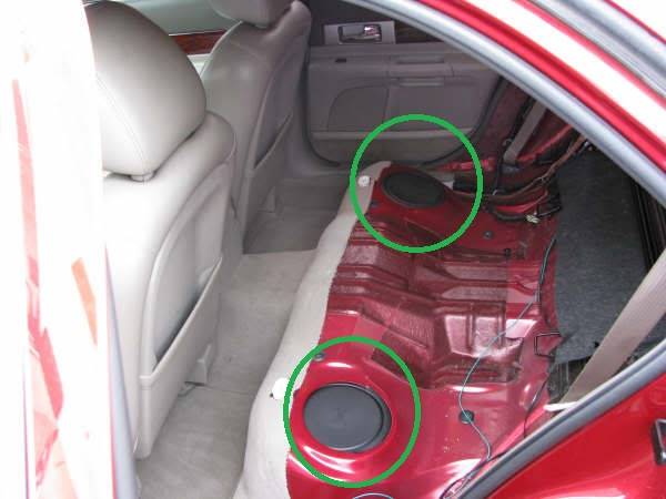

I am afraid you need to be prepared for a mess under the rear seat! There are access ports so do NOT lower the tank unless you absolutely need to!

We recently had the gas smell inside of our 2003 LS Sport. On the passenger side under the rear seat as the photo here shows, there was a small crack in the plastic top of the fuel pump and fuel was sitting on top. We replaced the fuel pump and our gas gauge has never showed correctly since. We opened it up again and tried moving the hoses that run from the passenger side to drivers side but didn't help. My mechanic checked using some kind of reader tool (forget what is was called) and said the fuel gauge shows working. I guess we could try and replace it with another fuel pump as it has warranty. Bought one from Rock Auto first, didn't work at all so had to run to o'reilly auto and pay twice the price as it was the only thing local I could find nearby.
