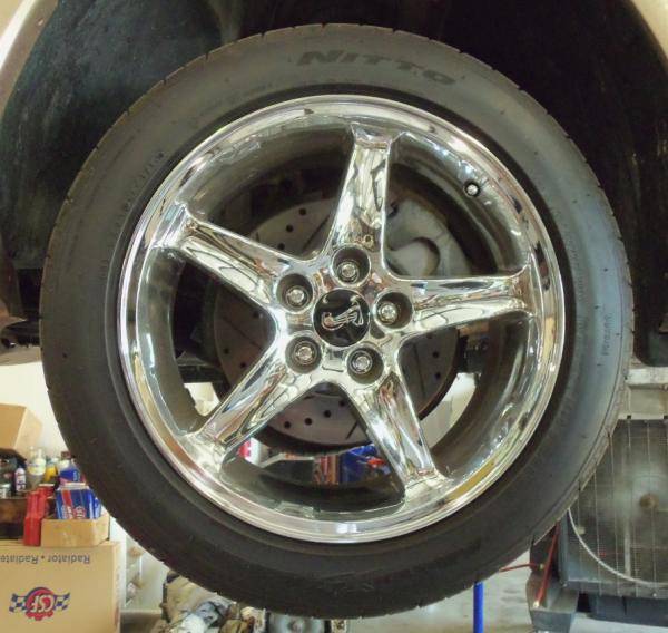

Just don't powder coat them. I bought mine used, and coated. The cast iron dust is hot enough to melt into the coating, then rusts. I had to scuff and paint the fronts.
Mine actually look exactly like those. Except being silver painted and the emblem is the cobra with the R in it.

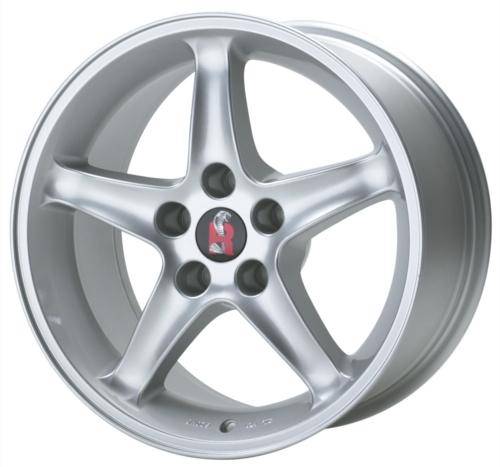

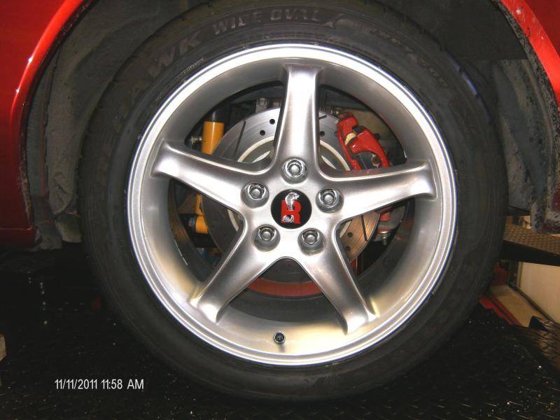

17"x9" Cobra R's are from the 1995 Cobra R, first pic.

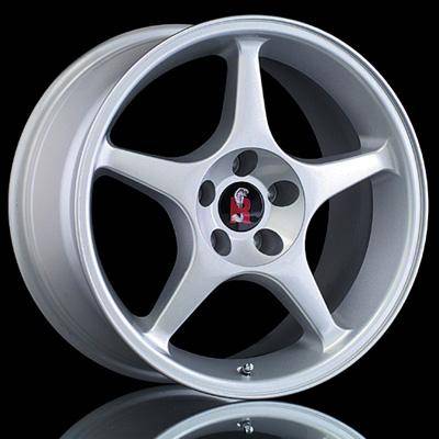

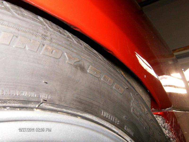

18"x9" Cobra R's are from the 2000 Cobra R, second pic

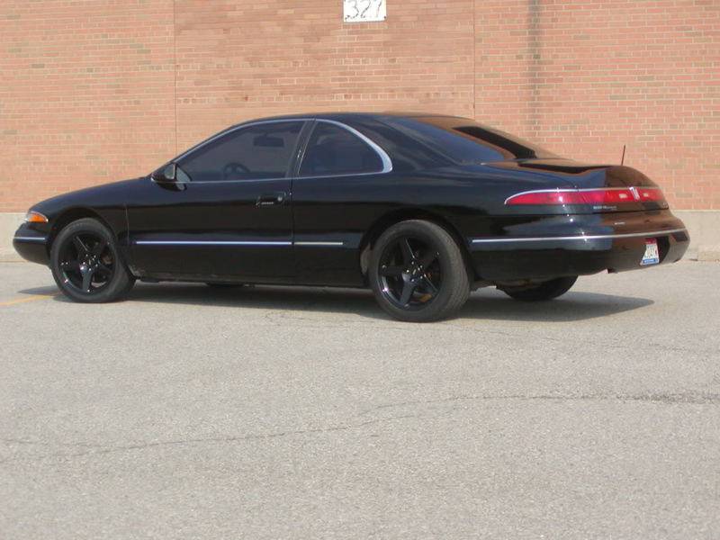

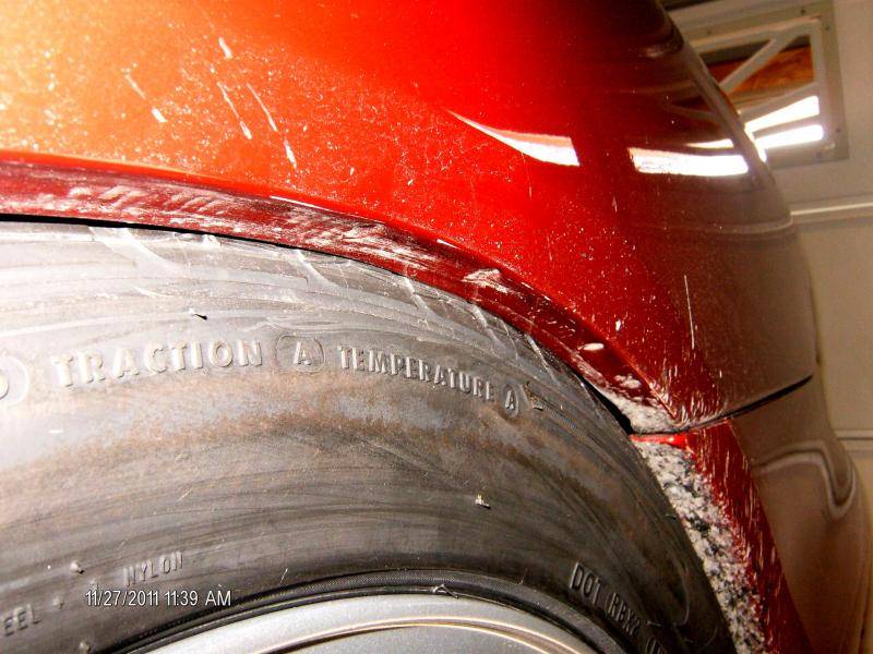

The third pic is a 275/40-17 MT DR mounted on a '95 Cobra R (R58 +24mm offset) wheel on my car.

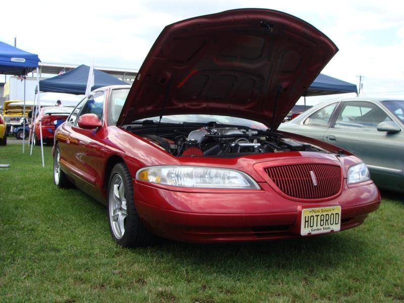

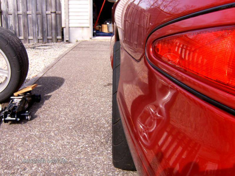

The fourth pic is a 275/40-17 MT DR mounted on a '95 Cobra R (M179 +36mm offset) wheel on my car. These wheels are extremely difficult to locate. However, the +36mm offset is what is needed, and even then I needed to roll the fenders.
The fifth pic is the M179 '95 Cobra R's and my street tires, 275/40-17 Firestone Wide Oval Indy 500's.
+24mm offset '95 Cobra R's and 275/40-17 tires will rub.

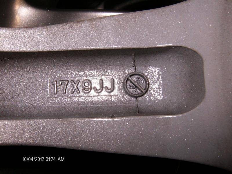

Took measurements on the rim and it's the 36mm offset set, guess that was a lucky purchase on my part.
Thanks for the info, they look to be the 95 cobra r rims. I am guessing the were listed wrong on craigslist when I bought them. Haven't really worked on a car since I had my old fox stang so everything with the mark viii is new to me.

If you actually got the M179 wheels, then you're very lucky. The offset should be stamped on the back of one of the spokes (see picture).
However, they may not clear the spindle in the front. Check very carefully for clearance.

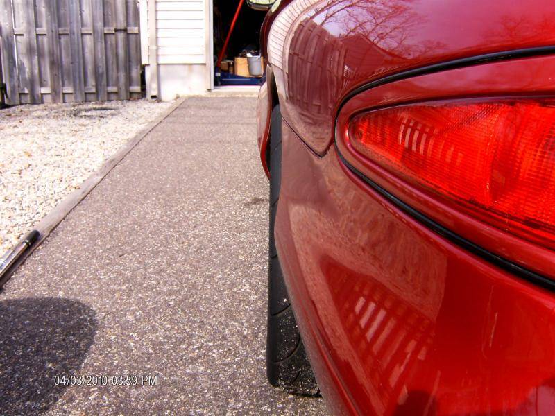

Before and after pics of the fender rolling I did for the M179 +36mm 17"x9" Cobra R rims and 275/40-17 tires.

The pics above are with the suspension almost fully collapsed. I just released the air in the bag in order to determine where to roll the fenders, that's not my ride height.
