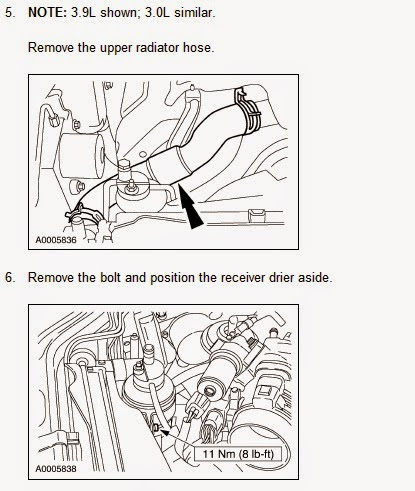

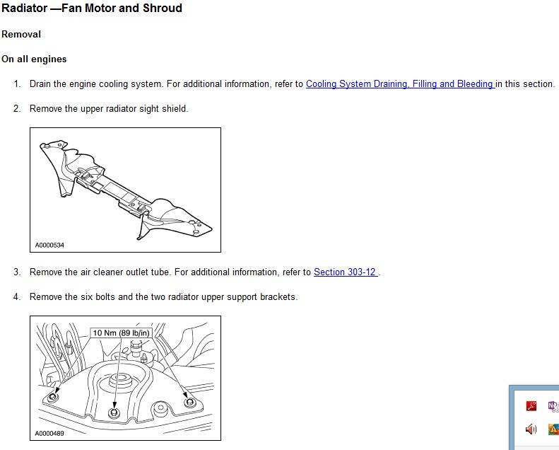

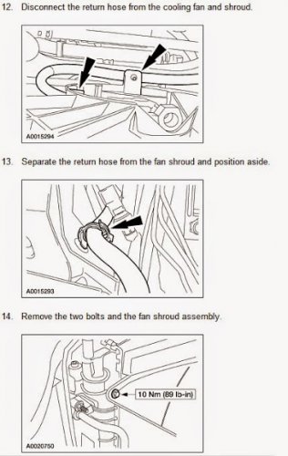

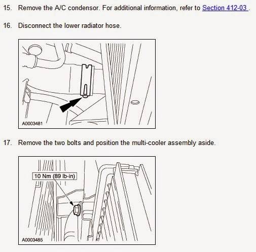

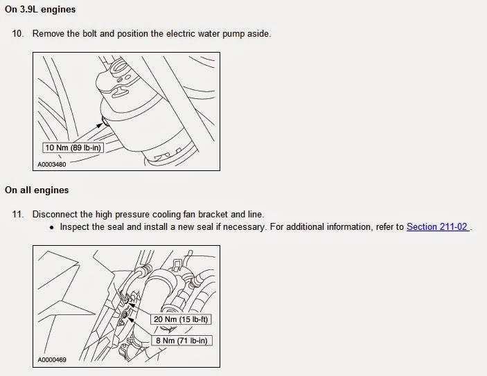

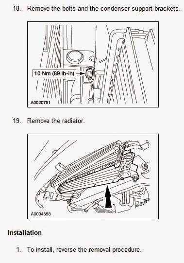

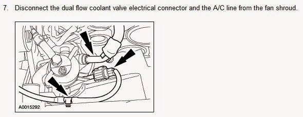

You should really consider purchasing a manual. That said, my manual didn't have the radiator removal procedure for a 2002, but here it is for 2001. Also, if it seems like a couple of steps are missing, those related to the 3.0 only, so don't apply to your vehicle. Good luck!

Be warned, you'll lose all of your AC refrigerant when you remove the condenser. Even if you don't get the refrigerant recovered, you should vent it in a controlled way, rather than just by disconnecting the condenser. I'd put a new receiver dryer on before vacuuming it down and recharging it. Also, when you vent it, stick the hose down in a bucket so that you can get an estimate of how much AC oil you lost.

The radiator is removed from the bottom.
A simple drop out push in.
Can be done in less then a hour. It took me longer the first time I changed mines cause I went at it from the top. The second time I went from the bottom and slapped myself from not doing it that way the first time.
