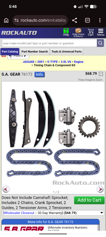

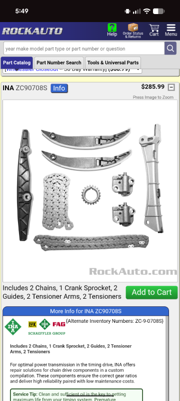

Thank you for the help! I tried them and ordered a couple of the parts that you have pictured there. They were not the correct ones. Some of the parts I've seen look close and I've ordered them just to find out that they are about an inch too long. Example would be the second one down on the list in your picture. I ordered it and cut my fingers crossed but no luck, had to return it. The part number isn't exact and was hoping that was an after-market thing but the part would be right. The whole number is correct for the right side guide besides the F8R in the beginning. Lincoln Ford has the part number as 1W4Z6K297CA for the right side and left side is the same besides the last two letters are BA. PartsGeek had a 2000 to 2008 Jaguar S-Type timing kit that had the correct guides that I already have that go against the tensioners but the kit stops there and there's no other guides. I also ordered replacement nylon to put on the guide and it comes too long so that results in the last connecting tab not lining up. Thank you again!

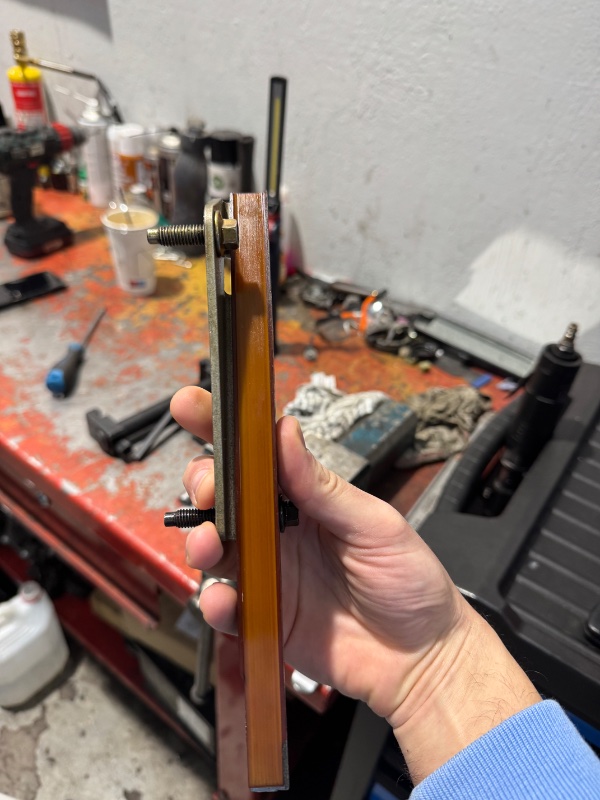

That does seem to look like one of them... I'm not positive. I'm hopeful because sounds like you are sure of it and I'm not too well-versed on this. I have 2 guides that I need yet one possibly being this one and the other "straight" guide. I want to attach a picture but it says file too large so I'll see what I can get to load, if any. Repeating but I have the two curved ones that go against the tensioners already. Looking for a part number and something to go off of to call Jaguar if that's what I need to do. Thank you again

1999-2002 JV6 “AJ60” (your engine) vs 2003 and later JV6 “AJ62” with vcti units
rockauto list the wrong parts because they think your engine is a duratec 30 out of a taurus/escape/etc.

You are absolutely correct! Thank you so very much for helping me out with the second to last part I need! The picture you have with the whole kit... The guide in the upper left darn near looks like I could possibly take and cut that extra bit off, unless it separates somehow and I can't see it in the picture, and that would come close to matching for the other side. Or am I looking at that completely wrong? Also, you're saying that the part that you showed me at RockAuto would be the correct one just so I got that right?

all the parts off rockauto are wrong because it thinks you have a duratec (taurus and escape) engine instead of the jaguar v6.
you can buy the guides attached to the 03+ vcti solenoid housing for a little over 2 bucks, they just clip in. it may fit with some modification. part C2C8279
