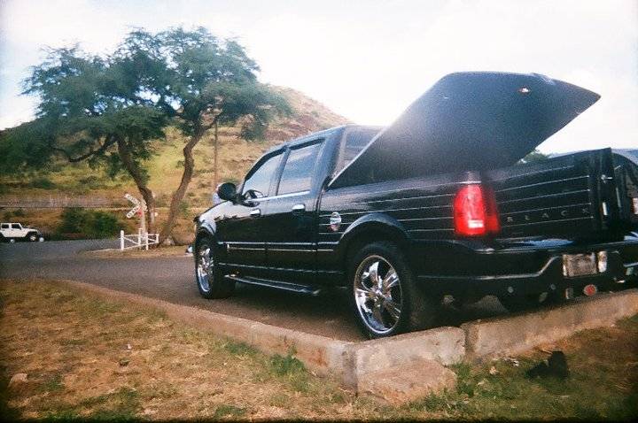

      Fixed suspension
      Thanks, I think I should also go back to the dealership and ask for my money back or at least get a credit towards the other air shock that will be going out next :D

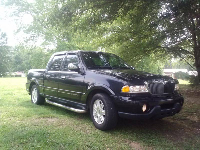

          I was wondering if the air springs fixed the suspension on your Blackwood. I have also had problems with my air suspension on my Blackwood and was considering removing the air ride and converting it to a coil and spring system. After reading your post I was wondering how the new air springs worked. Thank you so much for your post. =) blackwood.jpg
