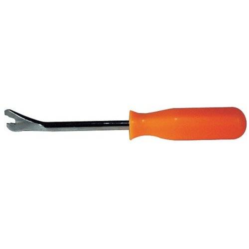

I used a panel removal tool and popped the assembly out. It came out pretty easy. I am still trying to find the smaller festoon bulbs.
Lol I just removed my visors, oh shtt handles, pillars, and front liner only to figure out that all you need to do is pop the 2 corners closest to the windshield with a very flat screwdriver grrrr
