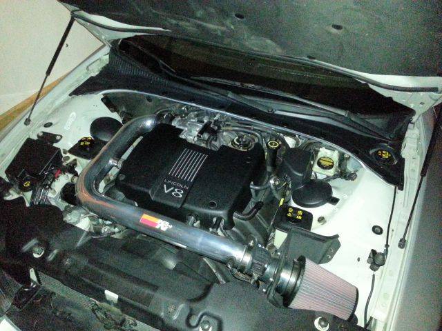

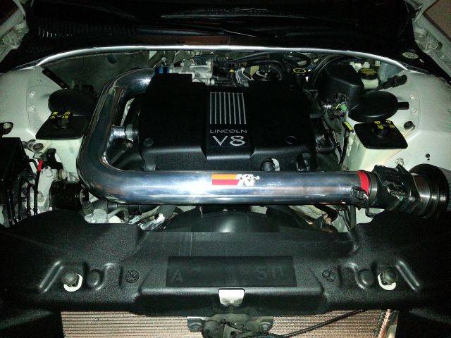

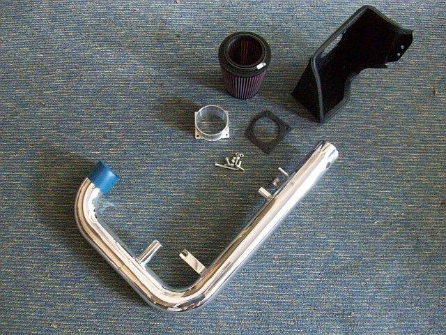

On my 01 V8 I went for the intake first. I had noticed how member hite337 had his done up and asked him what was all involved.
- ASMI Aluminum Intake Tube
- Spectre 8145 MAF adapter
- K&N RF-1015 Universal Air Filter
- Hite Performance CAI Heatshield

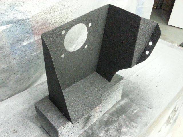

LVC member Hite337 makes cold air intake heat shields for the 1st GEN and they work out real nice.
they come in all aluminum and I trimmed mine up and gave it some color.
Gen1 Cold Air Intake Heatshield - http://www.lincolnvscadillac.com/showthread.php?t=78885

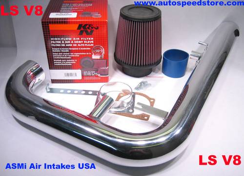

Next up is the ASMI intake system, it's sold on eBay here: http://www.ebay.com/itm/2000-02-LS-...r_Truck_Parts_Accessories&hash=item53eeb10c3c
There are other types of intakes available for cheaper but this one here will do you justice the most.
Looks like the kit is now being sold with the correct K&N air filter and the MAF adapter,
when I bought mine it did not and I had to source the Spectre 8145 MAF adapter and K&N RF-1015 filter separately.
8145 MAF adapter
http://www.amazon.com/Spectre-Performance-8145-Sensor-Adapter/dp/B002D37BYA
http://www.amazon.com/RF-1015-Universal-Air-Filter/dp/B00029WZIE

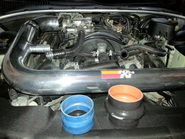

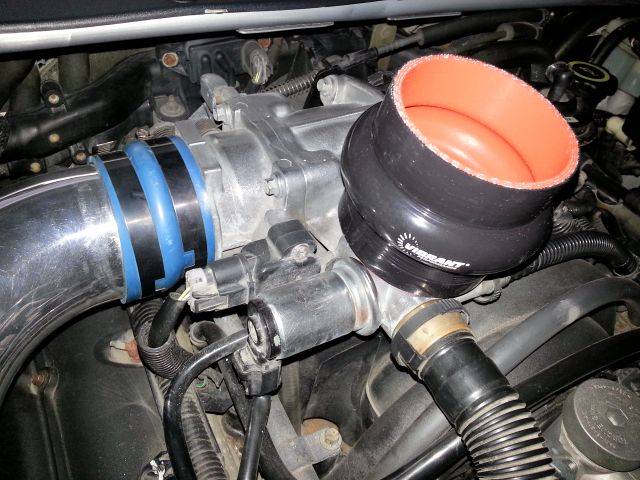

That blue Throttle Body intake sleeve will need upgrading, mine lasted for about half a year before I realized it was cheaply made and
with all the underhood heat it started to deform and took a bend downwards as the hood and ASMI intake will push on it under torque.
I ended up upgrading to a 3" Vibrant hump coupler #2734 ~ http://www.summitracing.com/parts/vpe-2734/overview/
That should make that whole intake look something like this,
Should already begin to sound a bit more beast with just the aftermarket intake on it just don't expect huge HP increases.
It'll open it up a bit and breath better, don't forget after such an upgrade to disconnect the battery cables for a good 30min
and reconnect to let the PCM reset it's new intake mixture settings.

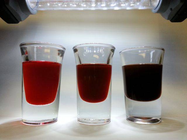

Fluid changes, I can't stress enough on changing some fluids out.
http://www.lincolnvscadillac.com/fo...-today&p=2037306213&viewfull=1#post2037306213
I just recently did my Power Steering and Hydraulic Cooling Fan Fluid, you can see how bad it was.
Left to Right,
1) Fresh new Motorcraft MERCON V ATF
2) Used Hydraulic Cooling Fan Fluid
3) Used Power Steering Fluid
It's rather vital to get some of those 10yr+ old fluids out and refreshed.

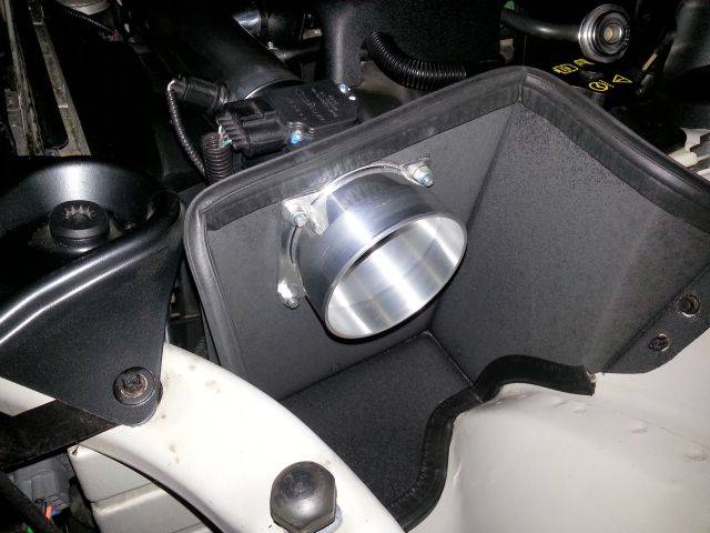

Another pic of my bolted in refreshed Heatshield from Hite Performance w/ the 8145 MAF adapter.

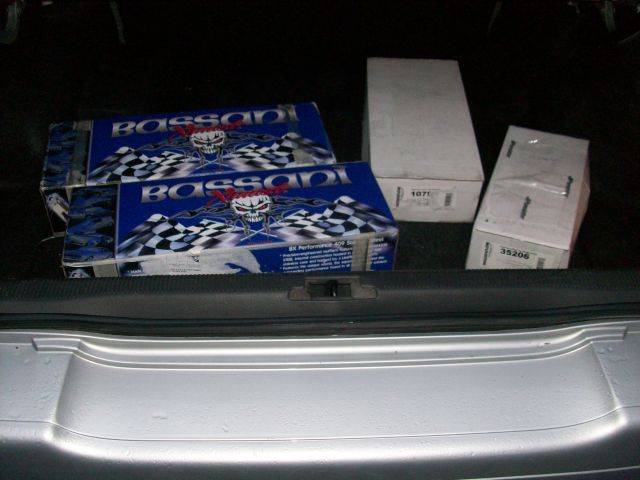

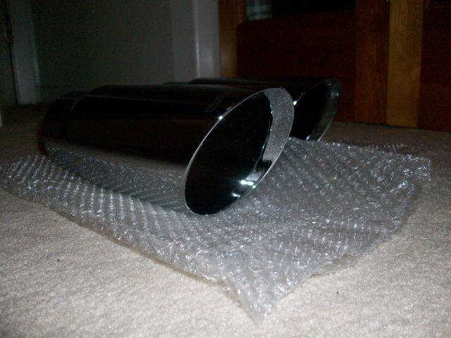

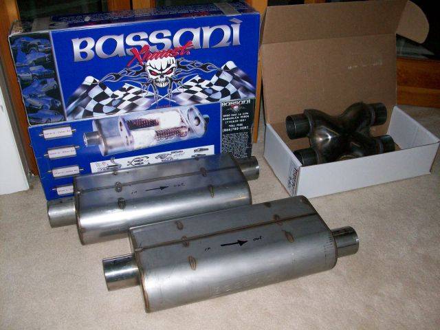

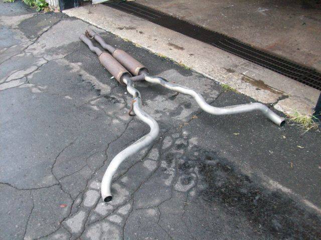

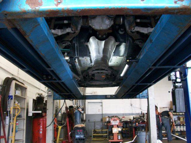

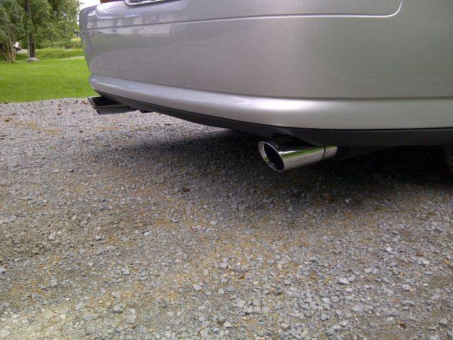

My exhaust in my vid that you PM'ed me about,
[video=youtube;ma8zw5hNxFo]http://www.youtube.com/watch?v=ma8zw5hNxFo[/video]
Bassani Universal Muffler #4820 Center In / Offset Out ~ http://www.bassani.com/display_product.php?product=90&cat=36
it's simply the BASSANI 4820 mufflers with the Magnaflow X pipe on custom 2.5 SS piping,
the resonators were deleted and running straight through.
- Bassani mufflers (#4820)
- 2.5" Magnaflow x-pipe (#10791),
- 2.5" SS piping from the cats back,
- Magnaflow tips (#35206)
Search BASSANI here and you'll see many members have gone this route.
http://www.lincolnvscadillac.com/forum/showthread.php?87750-bassani-muffler-and-x-pipe
http://www.lincolnvscadillac.com/forum/showthread.php?73293-upgrading-exhaust-Suggestions

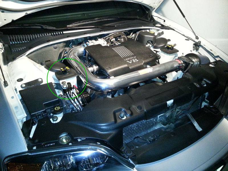

... where is the Electronic Fan Pump resevoir? And when changing the fluids, how do I take out the old fluid from the Hydraulic Cooling Fan and Power Steering? I'm guessing you could buy Mercon V ATF at Auto Zobe right? ...
See you have some problems here already,
Emil_ here's a link to the Tech section, it's part of the top menu bar: http://www.lincolnvscadillac.com/tech/?tabid=37
2001 Lincoln LS Owners Manual ~ http://www.lincolnvscadillac.com/tech/Lincoln-LS/2001LincolnLS-OwnersManual.pdf
You should think about downloading that and reading through it,
it's got the information in it where it's shows the location of your Hydraulic Cooling Fan Fluid reservoir.
Don't ever let anyone near it is my way of thinking. It takes MERCON V ATF fluid, don't add Engine coolant nor water there, it's the lubrication for the Cooling Fan pump, if you ever notice this oil go foamy or pinkish in color, replace it quickly with fresh MERCON and try and save the pump.
... it's the lubrication for the Cooling Fan pump, if you ever notice this oil go foamy or pinkish in color, replace it quickly with fresh MERCON and try and save the pump.
It's not just (or even mainly) lubrication. It's the stuff that makes it work. The pump pumps the fluid, and the fluid turns the fan.
8145 MAF adapter
I'll add a bit more about my Bassani exhaust later if your interested.
