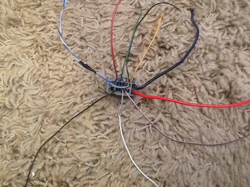

After looking online for far too long I found this forum and was impressed with the knowledge of your members and active willingness to answer posts. I hope someone out there can help me out. I am starting a build of a 1968 Ford F100 swb and after searching forever finally found a set a Lincoln LS seats (2001). I was able to make sure I got both ends of the wiring harness but now I need a "wiring for dummies" diagram so I can wire in the seats once I start putting my toy back together. I attached a pic of all the colorful wires coming out of the connector (connector is the "car side" that plugs into the seat). Any help would be greatly appreciated. image.jpg

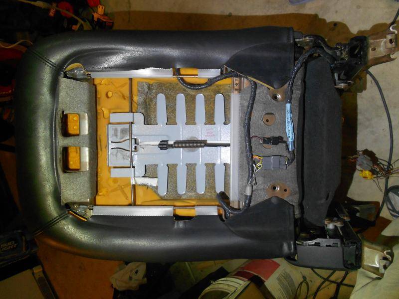

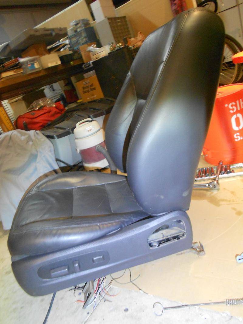

How about a picture of the top and sides of the seat, so I know which diagrams you need.
joegr - Seat pictures
Included pictures of the front, door side and seat back (with cover removed).

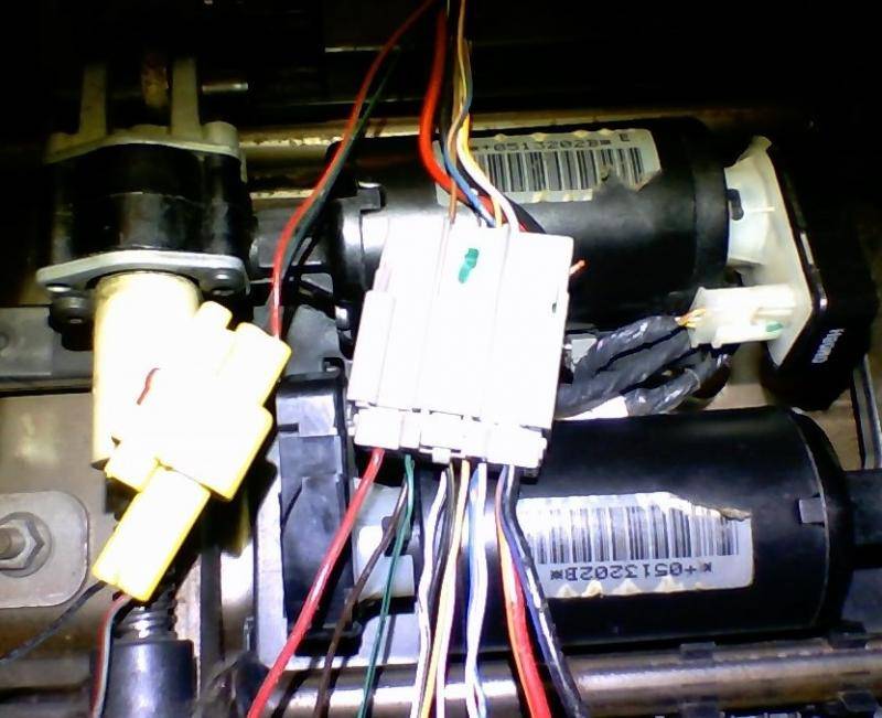

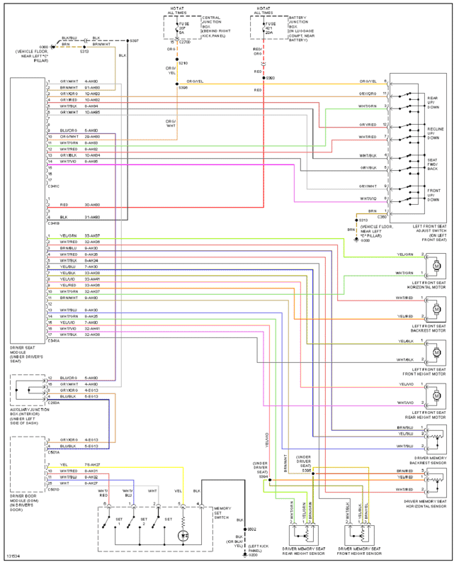

In the driver's seat there is a larger gauge red/orange wire and black/blue that I put 12v power through and got the power lumbar to work but not the other seat motions. I am suspecting I need to provide 12v power through additional wires but not sure which ones and cannot tell from the low resolution diagrams uploaded above. Thank you very much for any assistance!

The first two pics of the diagrams in post #22 are hard to discern because it's a bit too fuzzy.

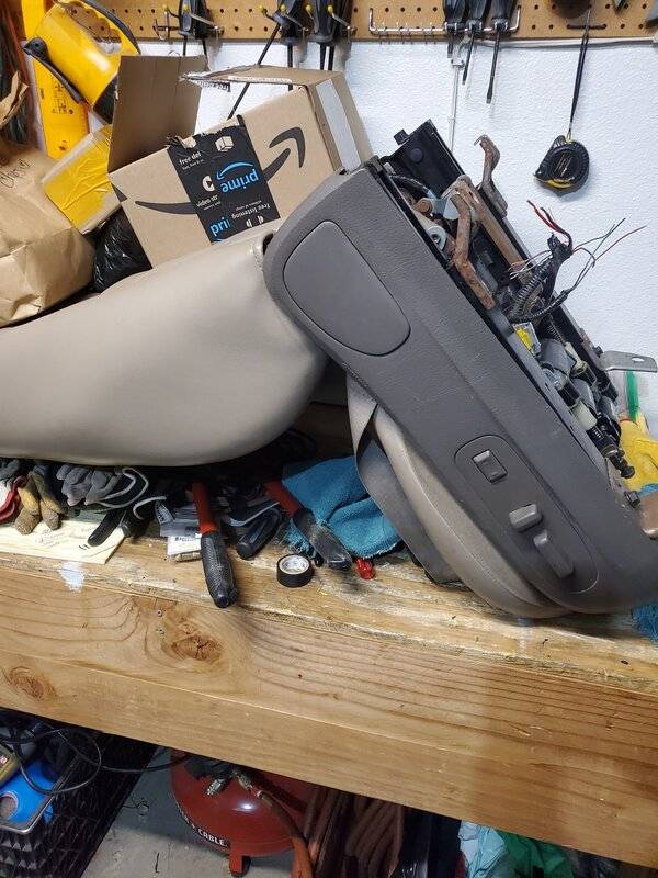

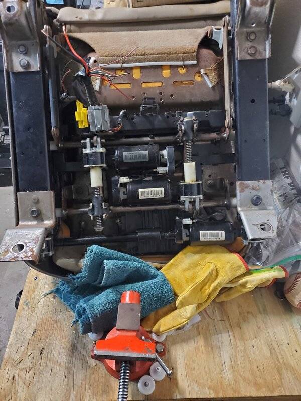

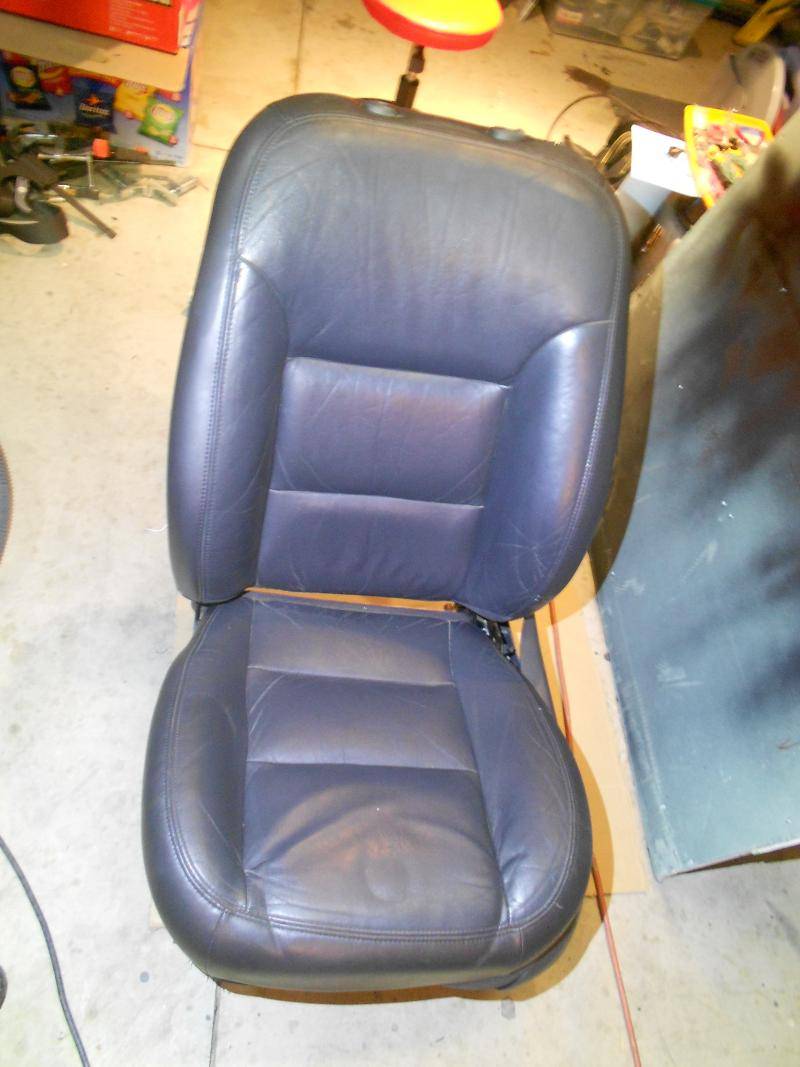

These are pics of my drivers side Lincoln LS seat.
Is there any way I can direct message you my email? Could you possibly email me the 1st two pics that aren't fuzzy? I'm sorry to bother u.
