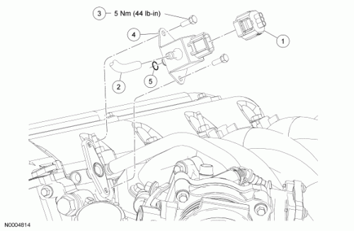

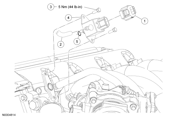

Here.......
Thanks bud, is that on the driverside or passenger side, rear or front of engine? And I am assuming its #1?
Looks like the front, passenger side. That looks like the TB lower, right of the picture....
1 14A464 Fuel pressure sensor electrical connector (part of 12B637)
2 9E499 Fuel pressure sensor vacuum tube
3 — Fuel pressure sensor bolt (2 required)
4 9F972 Fuel pressure sensor
5 — O-ring seal

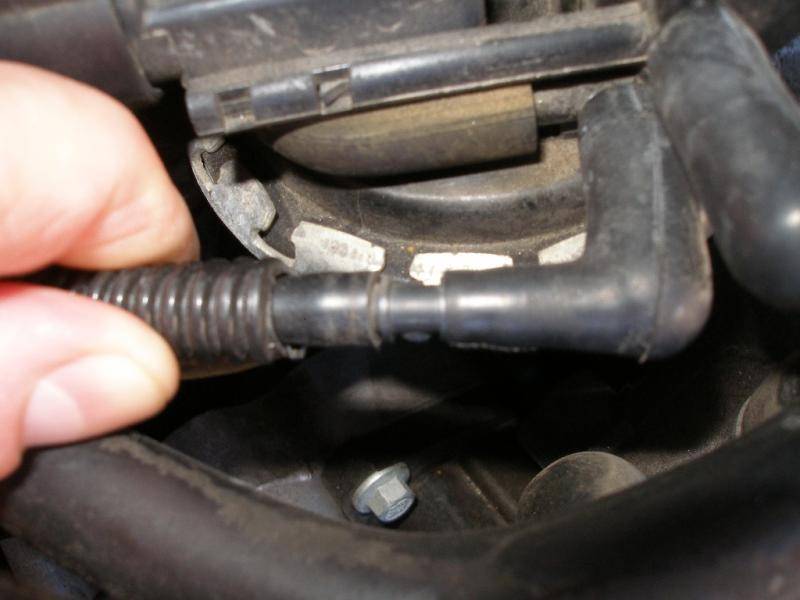

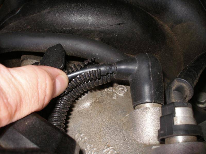

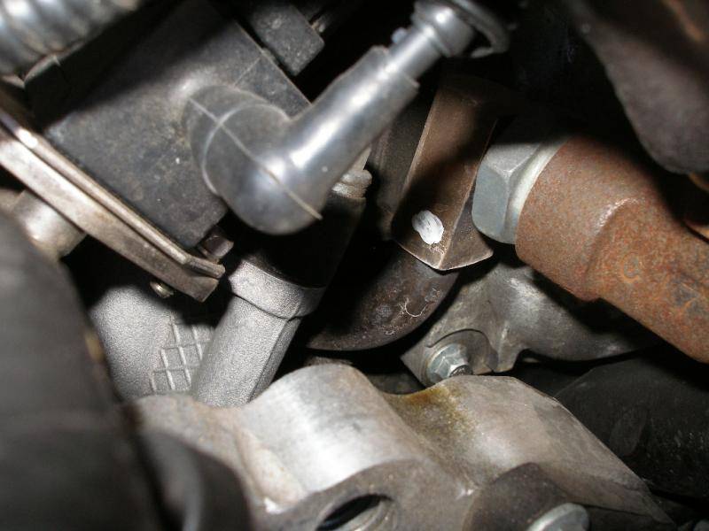

BTW, the vacuum line that goes to the fuel pressure sensor is part of the bundle of hard lines that go there and to the EGR assembly. Those lines are known to crack and turn to dust if you look at them wrong.
Thanks Joe. I'll check those out at well. It's definitely something causing it to drive terribly, worse then when I had a flashing CEL and due to two bad coils. I also ordered a fuel filter even though I changed it about 6 months ago, I guess it doesn't hurt to change it again.
Forgot about that. That happened to me a while (year or so) ago. I just went to Napa and bought some connectors and vacuum line. IIRC, repair was less than $20.....

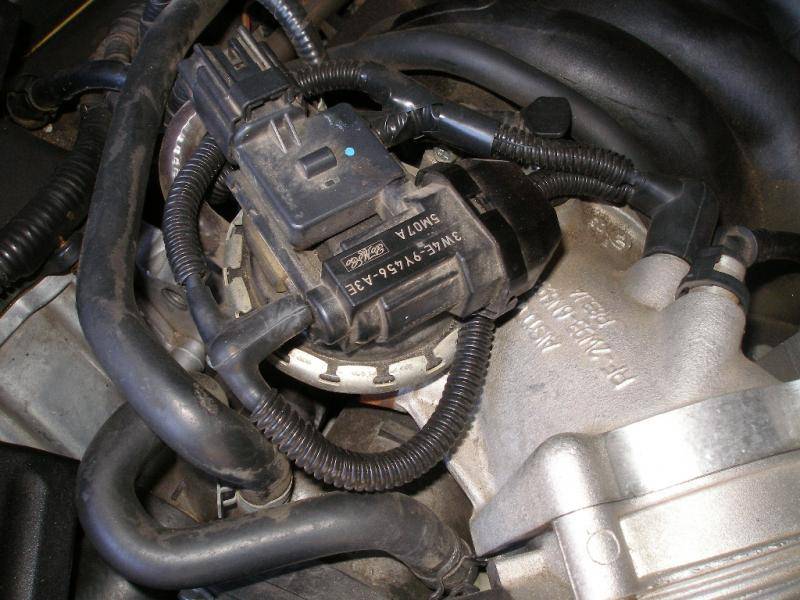

Ty for posting pics ! That really helps me a lot. I assume that piece showing is the fuel pressure sensor? Will be a fun Saturday putting on my new summer wheels doing the fuel filter. Coils. Plugs. And messing with these lines!
My pleasure!!!!!! That's the EGR in pic #1 and I believe that is the sensor in pic #3.
