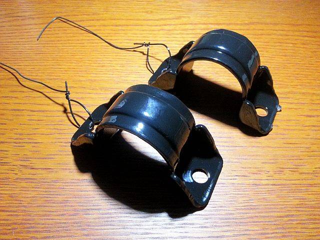

... something in my front suspension, it clunks over bumps.
Possibly: Front sway bar bushings worn out.
The inside of the hard rubber bushing, which is the inner part that wraps around the bar, it hardens over time, when it creates enough space/slack, it will start making a mild thumping sound when the front end travels slowly over uneven surfaces. The bracket and the bushings are stationary and the bar bangs around.
Note the bolts holding the brackets through, are long, to the point you think it's Christmas before it comes out.
Clean the dirt up around the bar where the bushings clamps down and a smear of silicon lube all inside the bushings. Grease the thread on the bolts. Some of the brackets bolts are more easily managed from the top, with long extensions and a swivel.
The DCCV needs to be moved slightly out of the way. It has two bolts, only one needs to come completely out, the other, I think it was the top one, only needs to be loosened as the DCCV bracket is hooked around it. As you loosen the bolt a few turns, the DCCV on it's bracket can be lifted up and around away from the bolt.
FYI: the ES bushings and brackets are too narrow and will slide end to end.
More here ( Sway bar bushings- sport or non-sport ) on why I do not like the ES bushings. You can work the collar to keep them in place or simply just get the right size bushings and be done with it.
There is a solution for the GEN 1 using the OEM brackets and obtaining the Jaguar Rein #XR819697 bushings from FCparts.
Jaguar Sway Bar Mount Front(S-Type XJ8 XK)- Rein XR819697 | FCP Euro
NOTE: These are the 30mm bushings needed for a Sport model, You'd need Qty x2
only grab these if your 1st GEN V8 is indeed a Sport. Base model any year, uses a smaller swaybar and these would not work.
The sport front sway bar is 30mm, the non-sport base model is not. The REIN Jaguar bushing would sit slightly loose on any non-sport LS. The REIN bushings are more suited for the 30mm Sport model.
Clean up original brackets and hardware and reuse.
