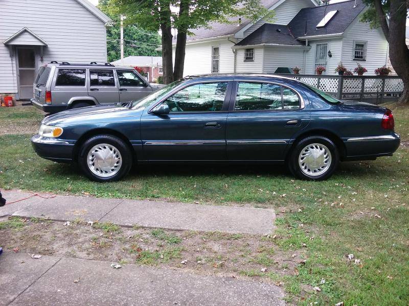

Hi guys,
Finally there seems to be a leak in my beloved 98 Conti and I am quite bummed, but nevertheless I want to keep the quality air ride, and fortunately it still rises and holds. The leak is slow and was found out after the recent cold spell here in Ohio, but I am not sure exactly what is leaking. It seems to take between 3 or 4 days to fully deflate and Most people seem to theorize that it is my air springs but of course it could be anything.
Basically I am hoping that someone can tell me just which company should I purchase the air springs from for good, honest and dependable ones? I have read and heard of some cheaply made products that fell apart in a short time from supposedly "reputable" companies that specialize in this field. I am very much in need and in no way do I want to got through a terrible experience that is costly and time consuming so I am looking towards the experts for your advice.
Thank you all and thanks for reading!
