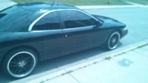

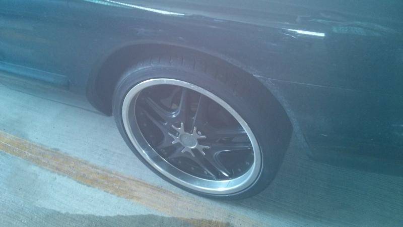

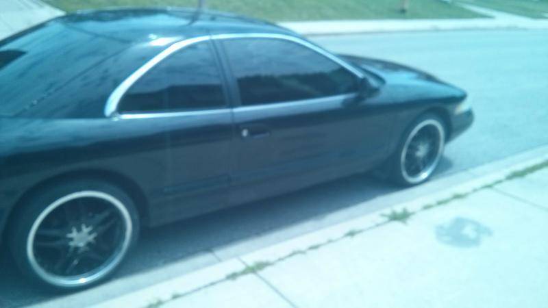

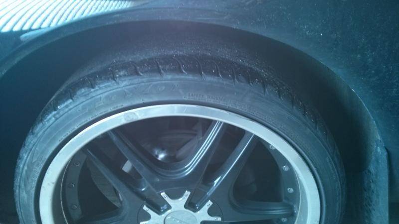

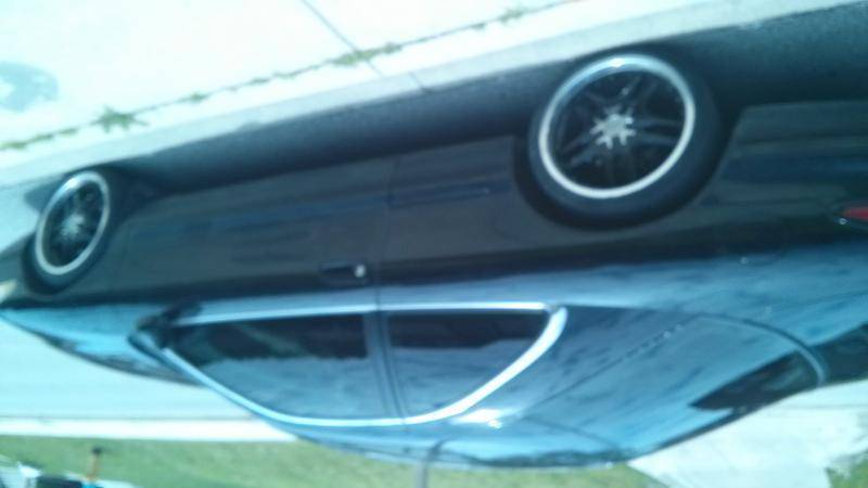

IMG_20140622_131855.jpgIMG_20140622_131905.jpgIMG_20140624_124843.jpgIMG_20140624_124858.jpg
These are the rim, dont have the car lowered...bad news...air pump died on my airride however just my luck a few days ago...it seems to run for a minute than starts stuttering and dies...for now at least I can just keep it off and turn on once a week, Im wondering if I can even get coil springs now with these on there?
Tires rub on back slightly when I hit a pot hole or a large bump, but nothing major, while turning no issues at all period do got an issue where car starts wobbling between 60-65mph when letting off the gas, I think its either because the caliper is still rubbing slightly or wheel needs to be balanced, main problem I had with these is my right brake caliper rubbing on the inside part of the rim, at first it was bad, sanded it down and it got better but still rubs once and a while, hoping its not damaging my caliper, mechanic told me the cast iron on aluminum will just wear the aluminum down over time, my buddies mark 8 had no issues at all with them
Yeah you can run a coil conversion without issue.
Your vibration at 65 is typical. These cars are very sensitive to vibration/wheel balance etc. Your alignment theoretically would change a little too with a different size wheel and that might be effecting it also.
