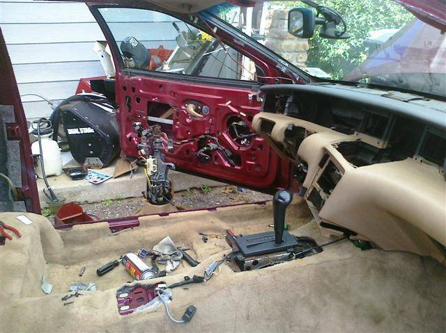

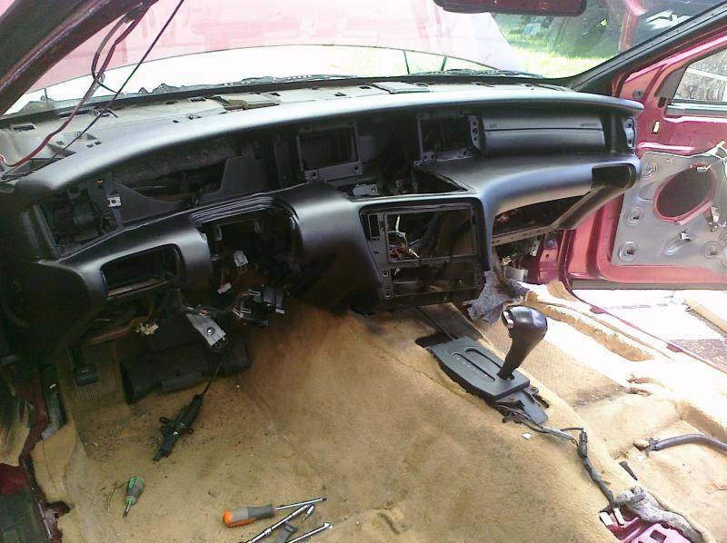

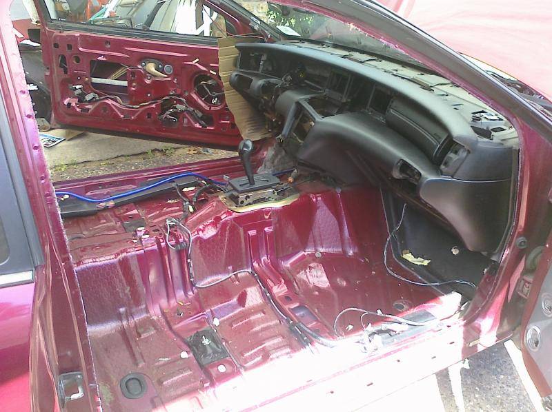

I swapped most of my black panels in so the only think I painted was the dash and center counsel .
