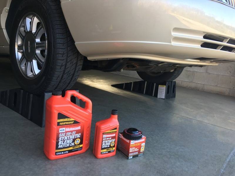

-MotorCraft Synthetic 5W 20 oil 6 quarts is the capacity in the oil pan. ( I use Motorcraft you can buy which ever you like)
-MotorCraft FL820S Oil filter (has the anti-drain back valve for lubricated start-up)
-Paper towels, brake parts cleaner to clean up oil drips, keep oil filter box to place old filter in, oil container to put old oil in to take to recycling.
1. Buy a set of Rhino Ramps to drive the car up on. Make sure the tires are planted on top of the indentations.

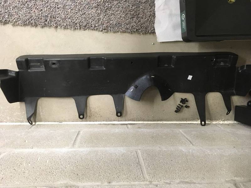

2. Take off lower radiator air deflector, there is 3 bolts you need to take off, then unsnap the 5 plastic push pins. (you don't have to take yours off, there is a oil filter access point on it as you can see. I took mine off when I changed my coolant.):

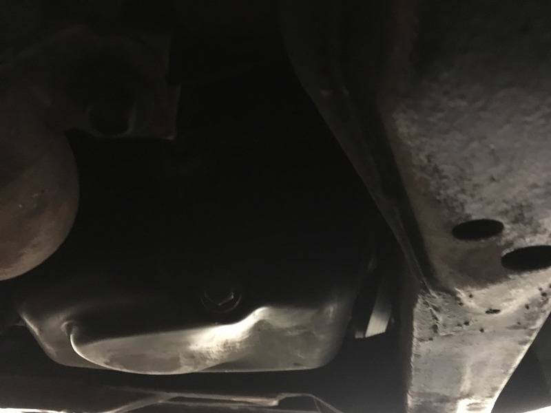

3. Place oil drain pan underneath oil pan on car. The oil pan is located on passenger side, drain plug is pointing toward back of car (the bolt in the center of oil pan in this photo) Sorry for the dark photo. Use 16mm wrench or socket to take out. Put drain plug back in when oil is done draining:

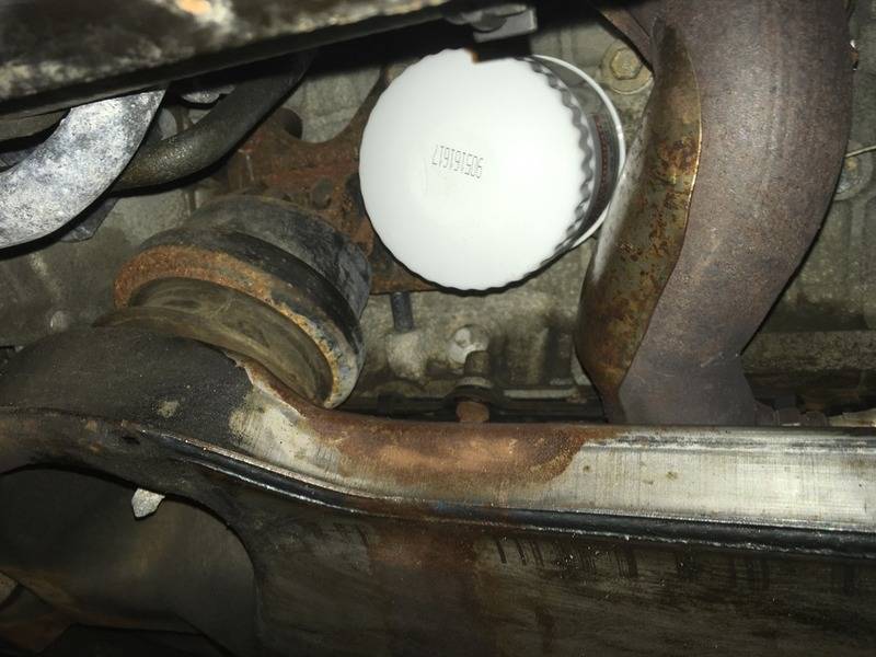

4. Place oil drain pan underneath filter. Put paper towels over subframe to capture excess oil spillage, Place plastic bag over filter, take your socket and extension with oil filter cap wrench and turn counter clockwise filter will come off and keep bag on it and will drop right in. There will be oil leaking all over but at least not as much. It worked for me. Make sure the gasket from the old oil filter came off with the filter. It is a black O-ring. Wipe off oil filter housing oil cooler, Pre-fill new oil filter about 1/2 way up, put some new oil on the new filter gasket on top, line up the filter onto the housing screw and tighten it clockwise by hand first. I used the filter wrench to tighten it about 1/2 a turn. Clean up mess with brake parts cleaner and paper towels get all the spilled oil off of subframe. (Don't be alarmed if you see a couple drips of oil later, there are holes in the subframe where the excess spilled and now is showing up. But check for leaks anyway:

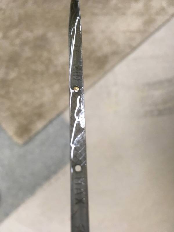

5. Put oil in 6 quarts, start car up, wait until the check engine light goes off typically 2 seconds. Turn on air ride, take tire chock out, turn off Emergency brake, back car slowly off ramps. Check Oil Level it should read below/at MAX mark:
