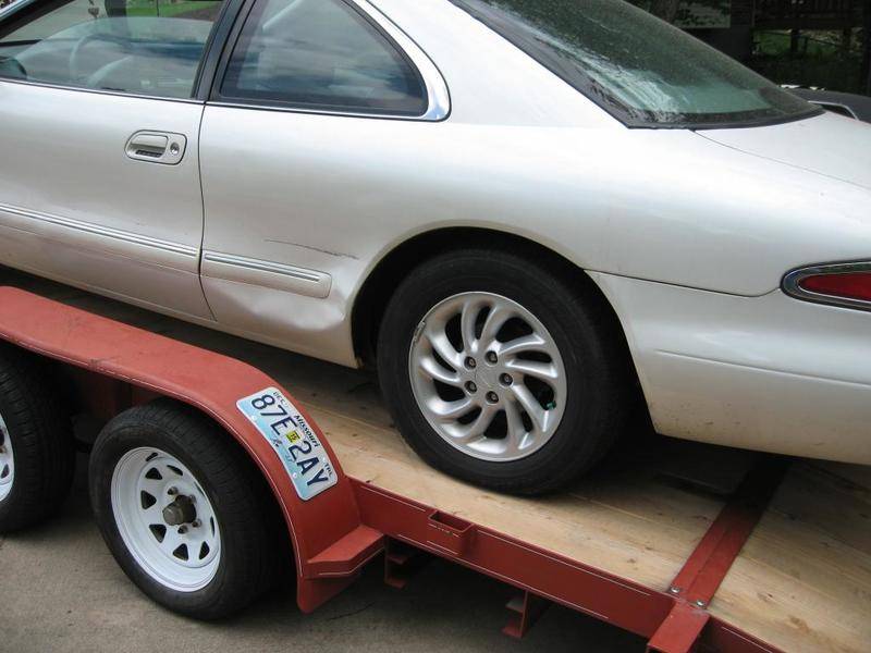

the car was sideswiped. dented the side and door. :(

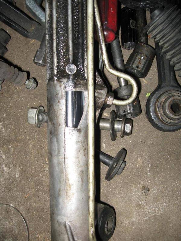

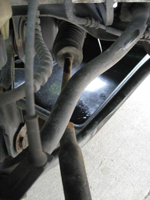

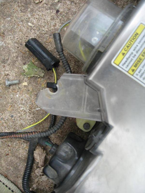

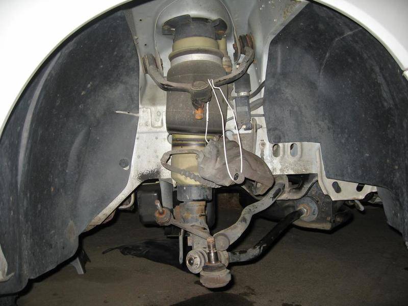

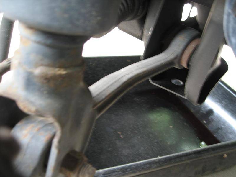

the rack broke. bent control arm. bent tie rod. broken headlight. easy stuff there.

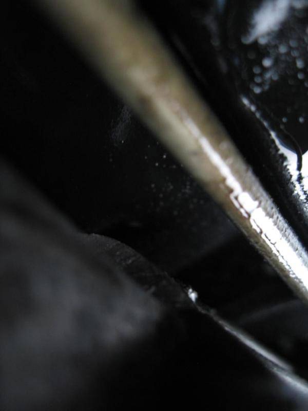

you can see the crack in the rack here.
bent tie rod
bent LCA

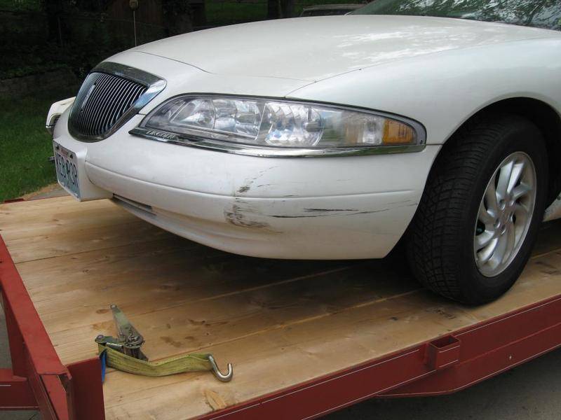

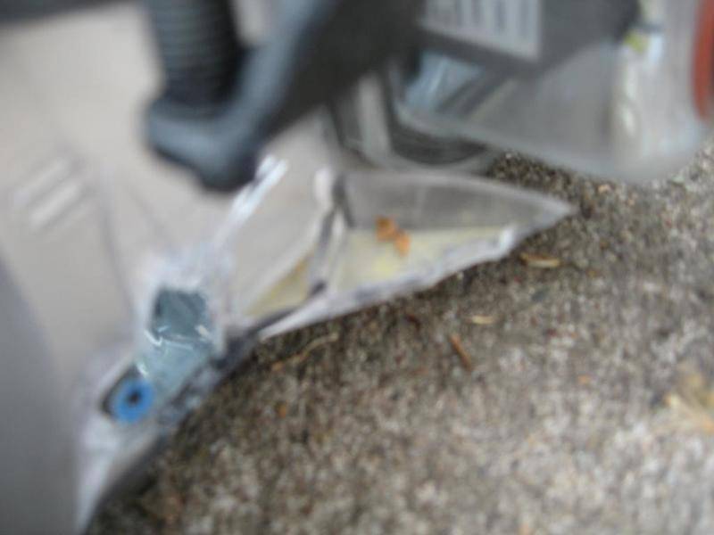

cracked head light tabs.

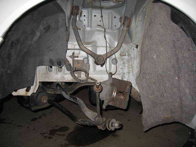

heres where all the power steering fluid went!

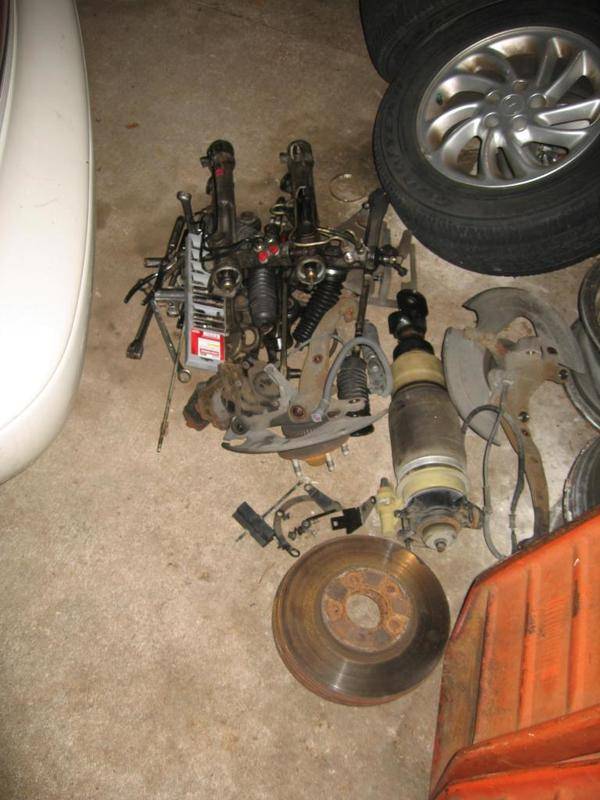

all the broken stuff removed. some replacements are on order.
my pile of parts and tools.
