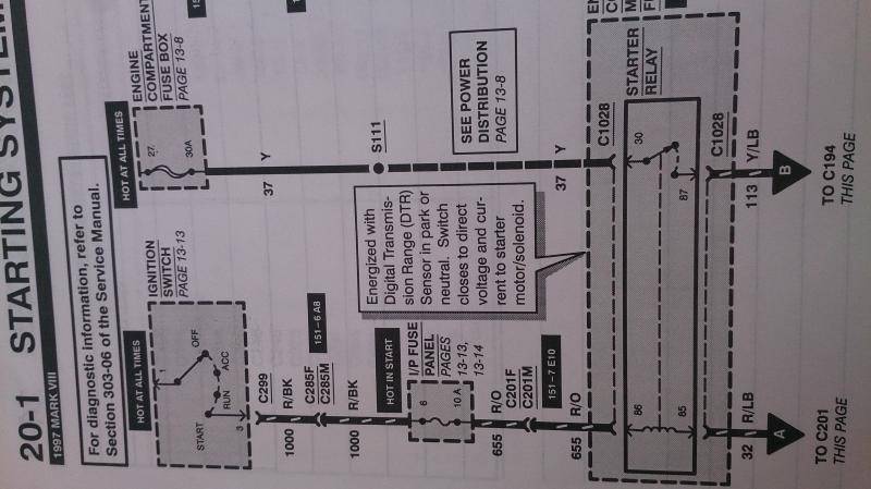

When the ignition is in the Crank position, power is getting to the fuse box #6 fuse and the starter relay.
What is the color of the wire from the starter relay to the MLPS ?

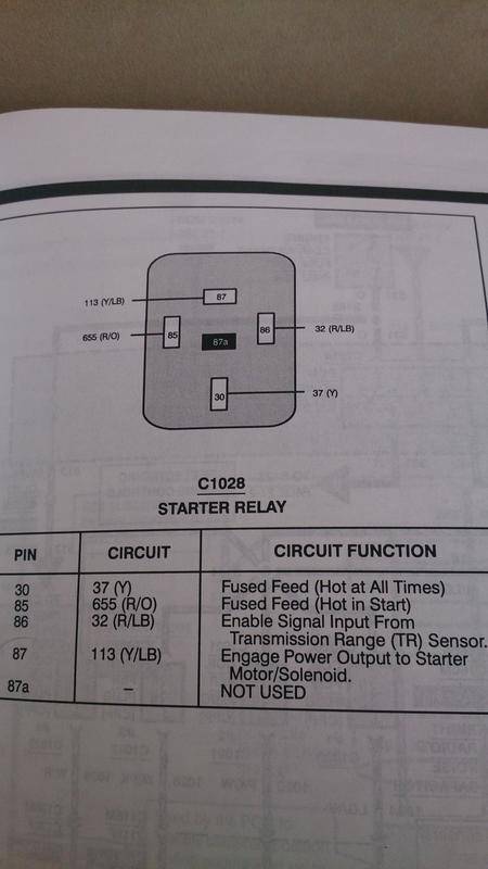

Here....
1) When a speaker wire is wrapped around PIN 85 on the starter relay, the test light's ground is clamped on the battery's negative terminal and the test light probe touches the other end of the speaker wire, the engine will crank when the ignition is in the Crank position.

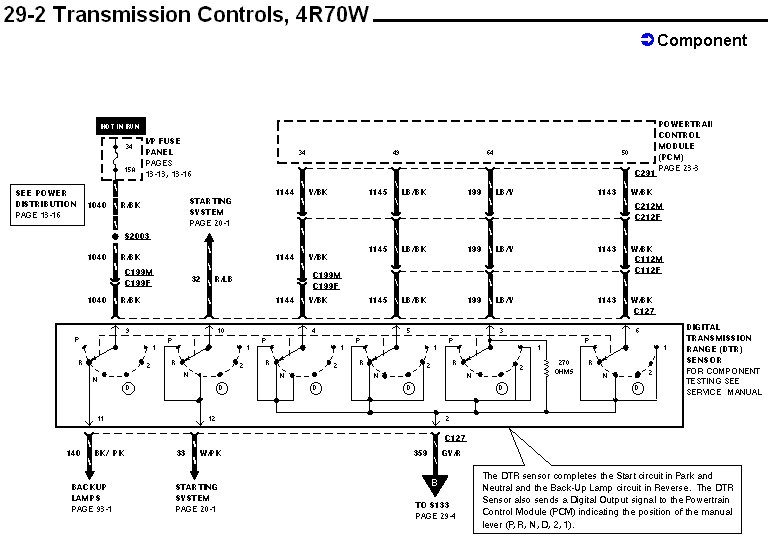

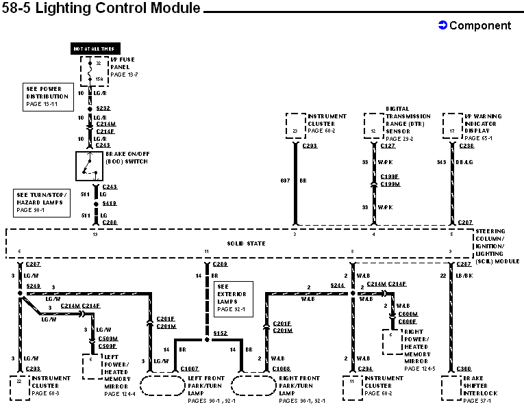

The above diagram shows a white/pink wire going from the DTR Sensor to the SCIL, but none of the wires look white and pink.
Where is the DTR Sensor ?

DTR is on the transmission.

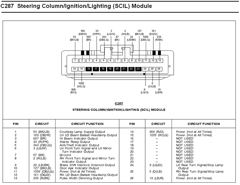

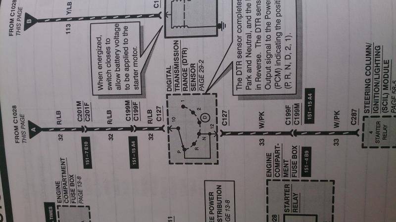

pin 4 of connector 287 is the one that goes to the starter relay (provides a ground):
This shows it going to the DTR:
This is where it goes to the DTR:
This shows that it goes from ignition switch to starter relay (12v) and how ground goes from SCIL to DTR, and if in park or neutral, to the starter relay.

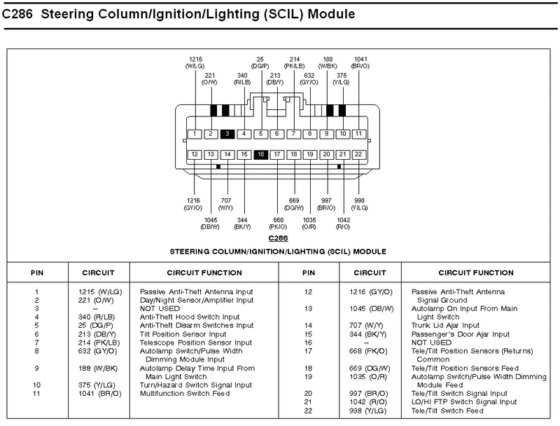

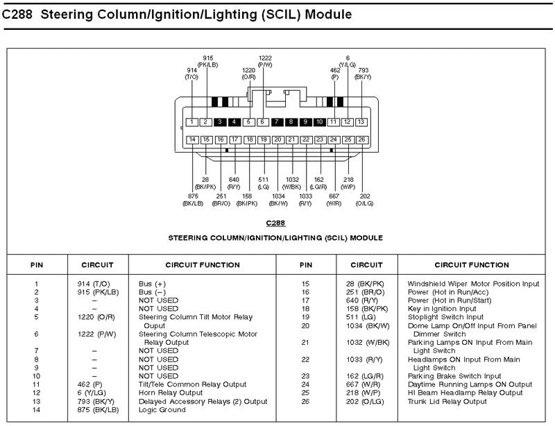

Pinouts for the rest of the SCIL connectors just for fun:
286:
288:

Since they already confirmed that the starter relay is getting 12v (I GUESS on pin 85, the red and orange wire), Checking for ground on pin 86 red/light blue wire. If no ground when trying to start, I would try in neutral and wiggle the shifter around to be sure it isn't the DTR. If there is a ground on pin 86, 12v in pin 85, then the output to the 87 yellow/light blue wire should have 12v when trying to start. It goes from there to a connector and directly to the starter. Did these starters have the ring end and threaded post/nut or the spade tip? Those are notorious failure points on the Crown Vics.

I guess at this point, I would try to establish a ground path for the starter relay on both sides of the DTR.
If grounding between the relay and the DTR works (circuit 32 - R/LB), it could be the DTR or SCIL.
If grounding between the SCIL and DTR works (circuit 33 - W/PK), the SCIL would have to be bad.
Since grounding pin 85 on the fuse box would allow the car to crank, could the moisture have caused the problem by causing corrosion on the ground coming off the SCIL ?
