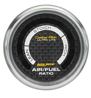

I got a air/fuel gauge already with a nitrous gauge that is packed some where. Should I worry about getting a fuel preasure gauge? I have one installed but its not readable from the inside.
Bottle pressure and fuel pressure are the two most important items when running nitrous. You want a viewable fuel gauge.
When setting up and tuning, pull the plugs often and inspect closely. I would not trust a run of the mill A/F gauge for critical fuel parameters when using nitrous. Always error on the rich side for safe engine operation.
So, I need a Autometer fuel preasure gauge. You don't trust the air/fuel gauges or just cheap ones? Mines autometers carbon series. Mine always seems to be one of two lines over on the rich side. . .

... You don't trust the air/fuel gauges or just cheap ones?
IMHO you want actual ratios not solely 'rich/lean' indicators to confidently tune for the nitrous. Once properly set up, the A/F meter would be fine to alert you of problems before they become fatal for the motor.
Its not just rich lean. Im sorry I think im miss reading you. I have this one. . .
