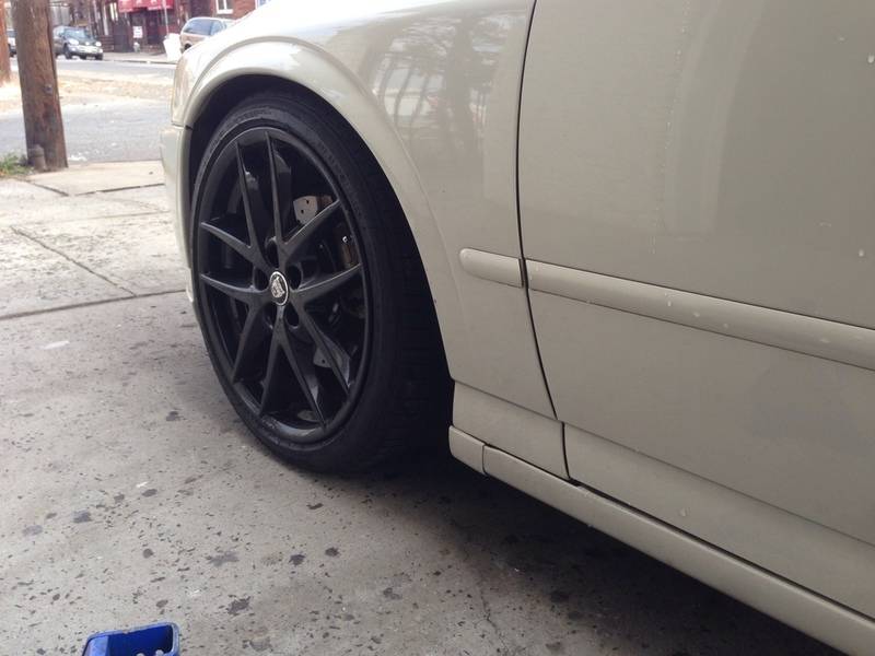

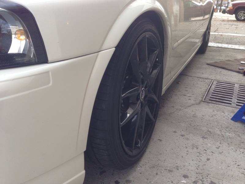

Some pics I took for Ben's LS
9.5" with 60mm offset and 255s up front:
I apologize for the filthy car...

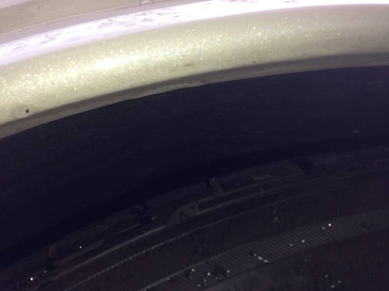

tried to picture the gap

Mlara1129 thanks for the pics. You have a little bit stretch but it is a 9.5 in wide wheel. I wonder what those would look like on a 9in wheel?

mlara1129, do you have any rubbing issues? rolled fenders?

And I never actually drove around with them upfront, But there seemed to be a lot of clearance.
