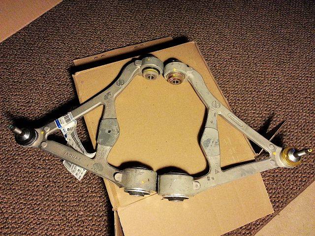

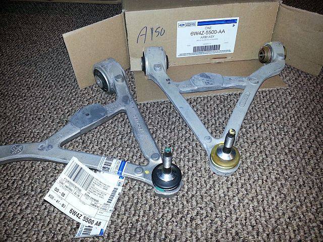

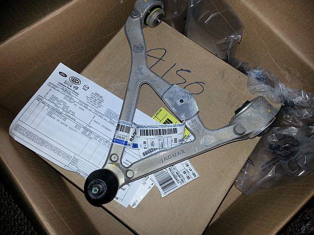

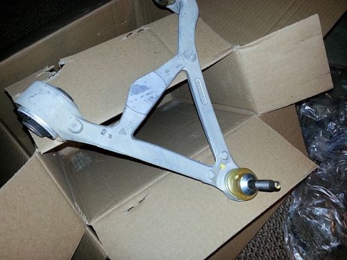

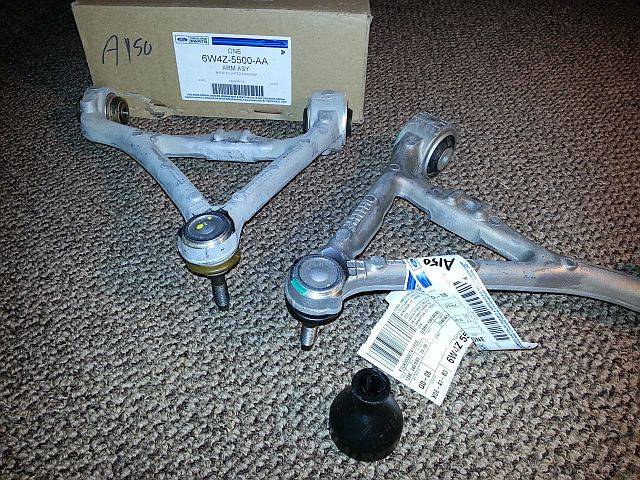

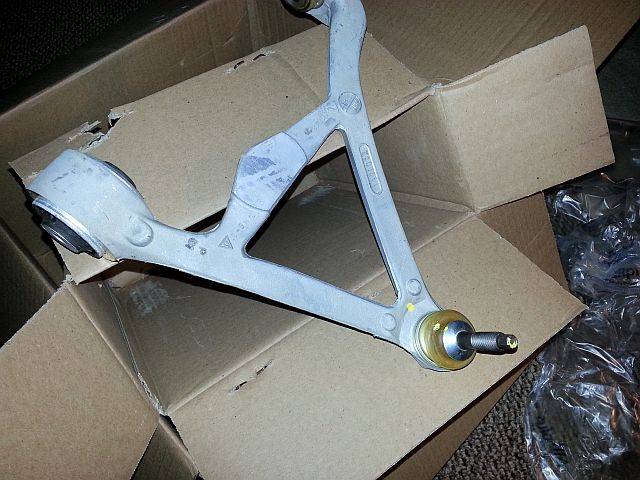

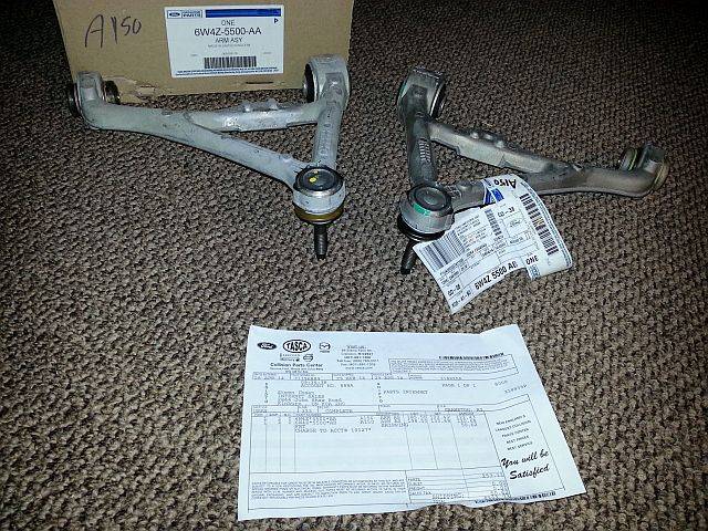

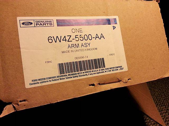

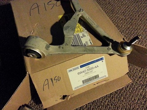

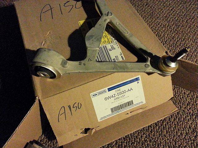

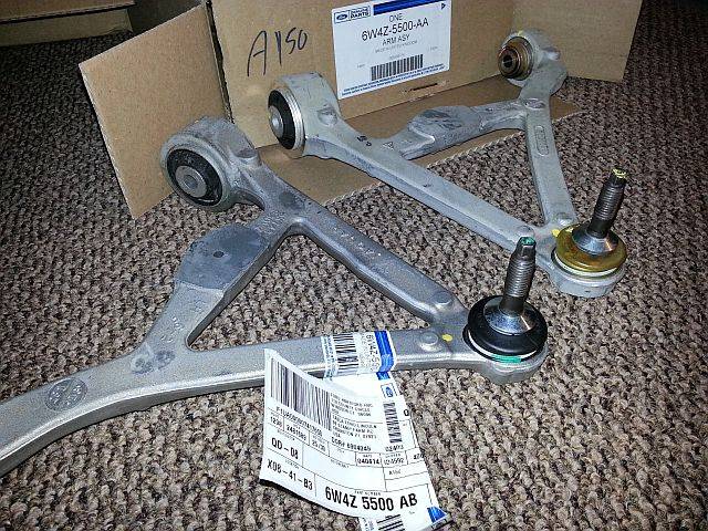

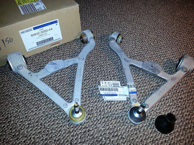

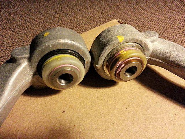

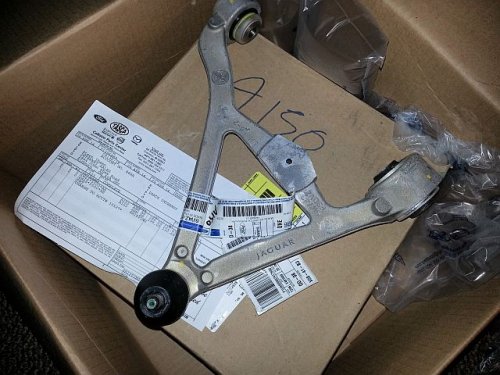

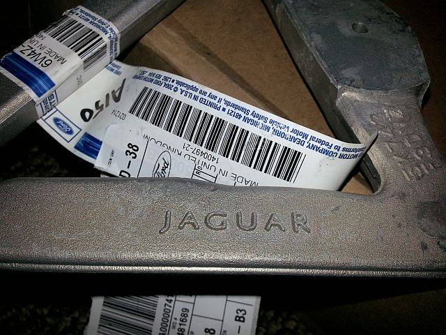

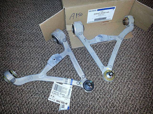

Once again, just a little side note, I ordered two brand new rear OEM Upper Control Arms from Tasca and was send one OEM with Jaguar stamped in it and one other that looks like a Fn knock off, The OEM Jaguar stamped UCA was loose in the main shipping box, the knock off was in a re-stapled FORD P/N box.
Not impressed!
They're all the same..
I figured. I just don't want to throw more money around and waste more time. Thanks.
Rig, I'm keeping my fingers crossed. What made it look like a knock off?
I started jacking up the back and the pinch weld folded over and the body looks to have caved in a little. Now I'm discouraged
Note the re-stapled OEM box which contained the non OEM UCA.
Could it just be a regular Motorcraft piece and the Jag one is the unusual one?

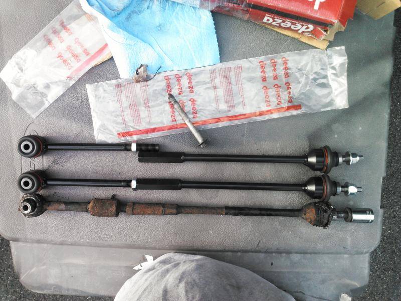

I got the toe links installed... it looks like I have major toe-in. I hope it's just a visual thing with the body or something that I just never noticed, because the Deezas don't even have a full rotation left to shorten them. I'll get an alignment after the UCAs come in, but I did match the lengths to the original links.
I don't know why they're so long. I measured the depth of the inner nut to be the length of the outer's threads. They should have another inch to go, but something was stopping both links. This picture has: unassembled, assembled at shortest, original
