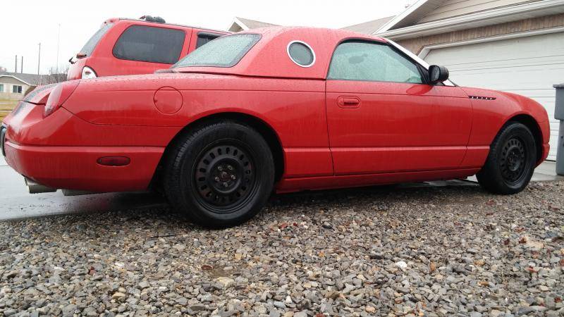

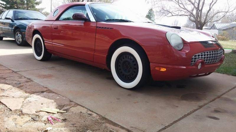

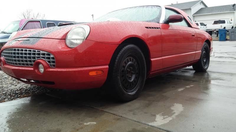

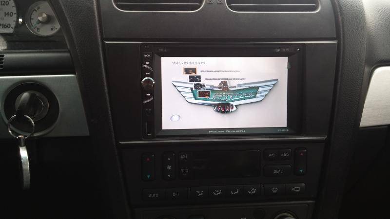

What up LS dudes? My names Nick I've got myself a 03 thunderbird with the same set up as a V8 LS way more info on this site about my bird the thunderbird forums are like a retirement home. Look forward to learning about lowering, interior mods and possible making the bird a manual.

A little off topic but I kinda like the instrument cluster of the bird sine the ls shares the same interior does the instrument cluster work on our ls. Hmmmmmmmm
