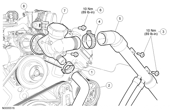

Neither did I twice. I fill it through the bypass housing, close the cap, fill the surge tank, crack the bypass housing cap 'till liquid runs out, run it, let it cool a couple of times, top off the surge tank (last time I added a little coolant twice). If there are any doubts, crack the cap on the bypass housing 'till liquid runs out.
Car fixed. My problem turn out to be a failed Aux coolant pump. Pump was leaking and not running. I let the dealer replaced. I was tried of laying on the ground.
What's the bypass housing? The cap in the middle of the engine?
I think he's talking about the thermostat housing.
So other then the thermostat housing and recovery tank, what are all the other "plastic" cooling parts that seem to be problematic?
The outlet pipe (it's the back half of the thermostat housing), and the plastic parts in the middle of the two radiator hoses.
